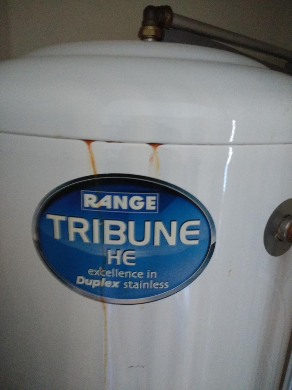

About 12 days ago we noticed that our water tank constantly had water running out of it down the tundis (which was blocked) and caused the hallway to flood. We managed to sort out the blockage in the pipe under the tundis but ever since, there has constantly been water running from the tank. We have also noticed that the tank has started to bevel and is no longer perfectly round.

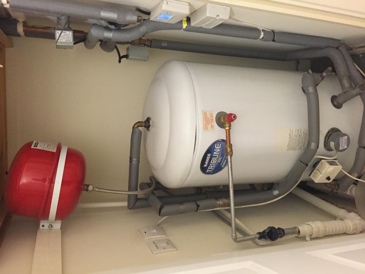

So we got another plumber around to have another look to see if they could explain it and they are saying that the expansion vessel (which was fitted by plumber number 1 a few months ago) is in fact the incorrect part and is only meant for a heating system, which has caused a pressure issue which is causing both the running water and the beveling of the cylinder.

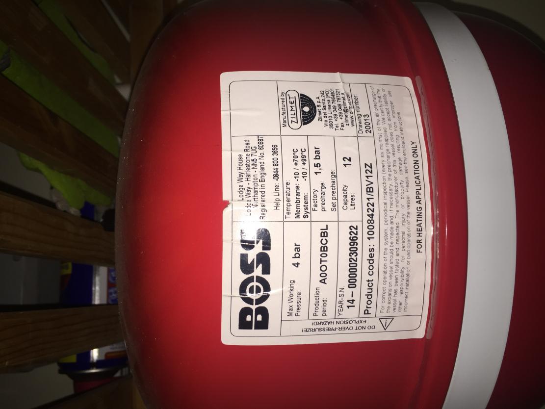

Can you see from the picture if the expansion vessel fitted is an incorrect type?
Thank you again.
The vessel in the picture is designed for use on non-potable water systems (red colour and clearly marked "For Heating Application Only"). The vessel will have likely failed and as croppie says, it could cause the cylinder to then fail. This type of vessel I not suitable for systems where the water supply is constantly replenished.
as the Red expansion tank always been their ? or has it been replaced at some time ? ask some of your nabours if they have the same colour (Red) tank fitted ! this could be a bigger issue, can you contact the developer maybe all the flats will need putting right

I would have the second guy change the expansion vessel, first check he is G3 qualified!
Then make sure when he's fitted it he then makes sure the pressure is correct for the cylinder.

The bracket looks right the vessel doesn't (2nd pic says clearly "Not for Heating ")

Expansion vessel not suitable for mains pressure associated with unvented cylinder. Hopefully deformation is just insulation, otherwise plumber number 1 will be picking up a large bill.
Is that an isolating valve I spy fitted on the mains pipe between the combination valve and the cylinder?
Not allowed as the pressure relief valve will be isolated from the cylinder when valve off!
Also, the combination valve is not in a serviceable position as it is behind the cylinder and too low.

Metty, please get somebody in to sort that. Its hard to tell be the picture it looks like its short of other parts unless they are stuffed down the side . It defiantly doesnt have an expansion valve, an absolute muppet installed that. The control panel down the back had me in stiches .
Has the outer casing always been buckled , because thats what it is . a casing ! .The actualy stainless cylinder is 50 mm under the casing and hopefully will still be ok .

I think the combination valve, with the pressure relief valve as part of it, is behind the cylinder.
I can just see it in the photo and I think the discharge from it does go along and tee off above tundish. Why anyone would fit a combination valve there is beyond me!

The casing has only become buckled within the last couple of months, we are in the process of trying to get it sorted (hence the thread) we are just trying to make sure this time we get a good plumber as we don't want the same issue again.
