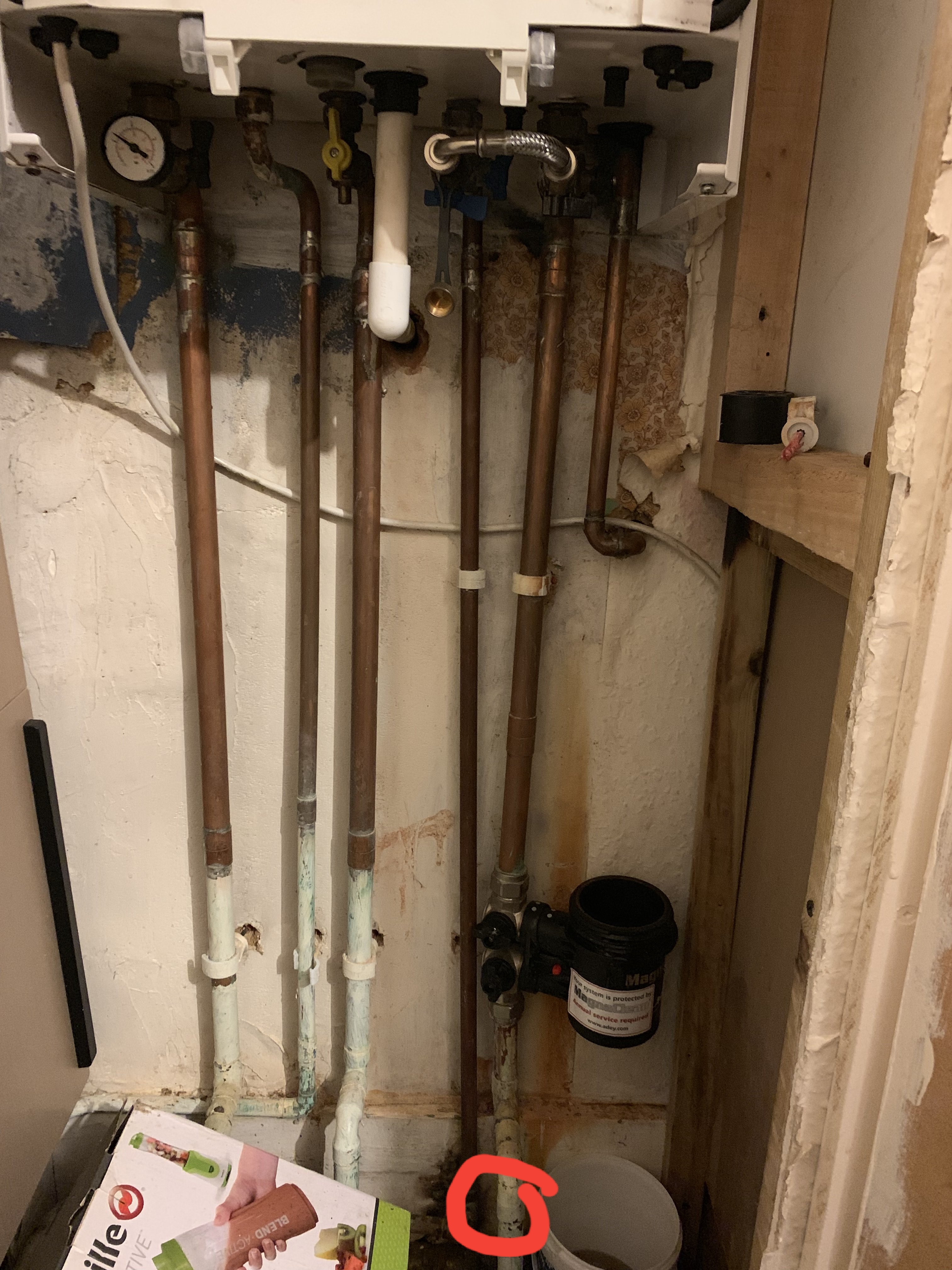

System showing 1.5 bar magna clean lid opened bottom valve open, no water coming out of magna clean
I'd be tempted to cut the pipe below the elbow circled in red. Then check the pipe leading up to the magna clean. It is unusual for a 22mm pipe to block though. There isn't anything stupid like an isolation valve under the floor in the cupboard is there?

Both magna clean isolation valves do open...... the pictures shows the top valve closed, when opened water be flows out of the magna clean, the bottom valve is in the open position and actually opened but no water flows out.... I have checked it with the magna cleaned removed ....
