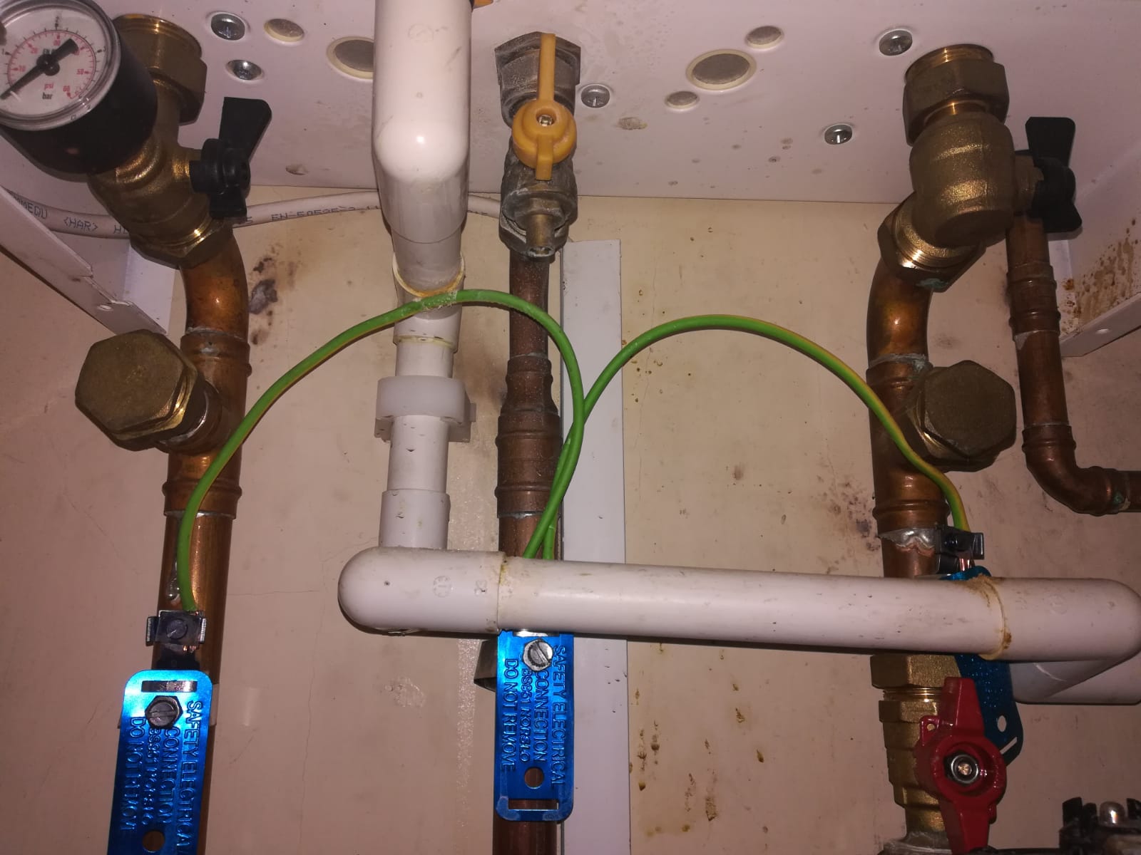

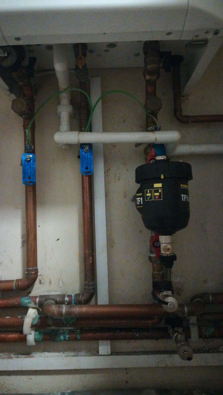

Hello everyone, a friend of mine has recently had a F1 error on their boiler (Ideal Logic System 24).
We have looked up what to do and it looks like we need to increase the pressure on the boiler. Seems simple enough. but with the way this was installed we don't know how to do that. we looked up youtube videos and other guides but all the setups were different.
Attached are pictures of the setup, any advice would be appreciated.

Bottom right first pic the two silver valves
Your missing the flexi loop if you can find it undo the two caps and install the flexi
Then you should be good to start filling

Oh wow thanks!, don't believe I didn't notice that.
are you able to buy the flexi loop at diy stores?
Whole new filling loop but you can use the flexi off that and install it onto the valves you have and then just keep the valves for spares

Would something like this be fine?
https://www.NoLinkingToThis/p/combi-straight-filling-loop/46605
