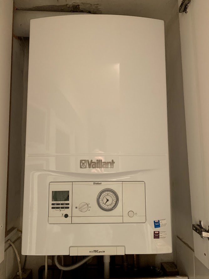

Vaillant EcoTec 24 Pro.

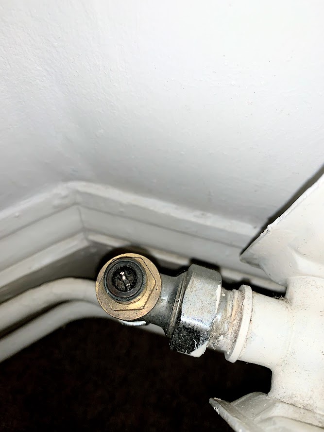

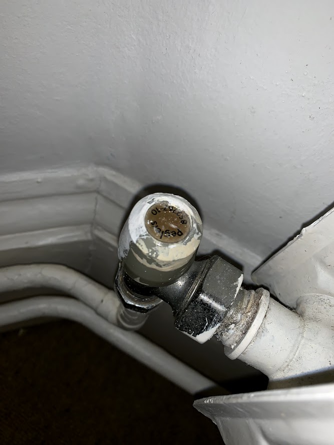

To be clear, with the isolation/lockshield valves, right? Some have "innie" slot/blade screwdriver-style, not nibs/nipples like what I'm seeing on Youtube (I assume the newer style). I assume it's still a right to close, left to open thing. (Dumb questions but don't want to be mucking this thing up more.)
I should clarify that I come from a country where forced air heating is much more common than hot water... so these systems are pretty new to me.

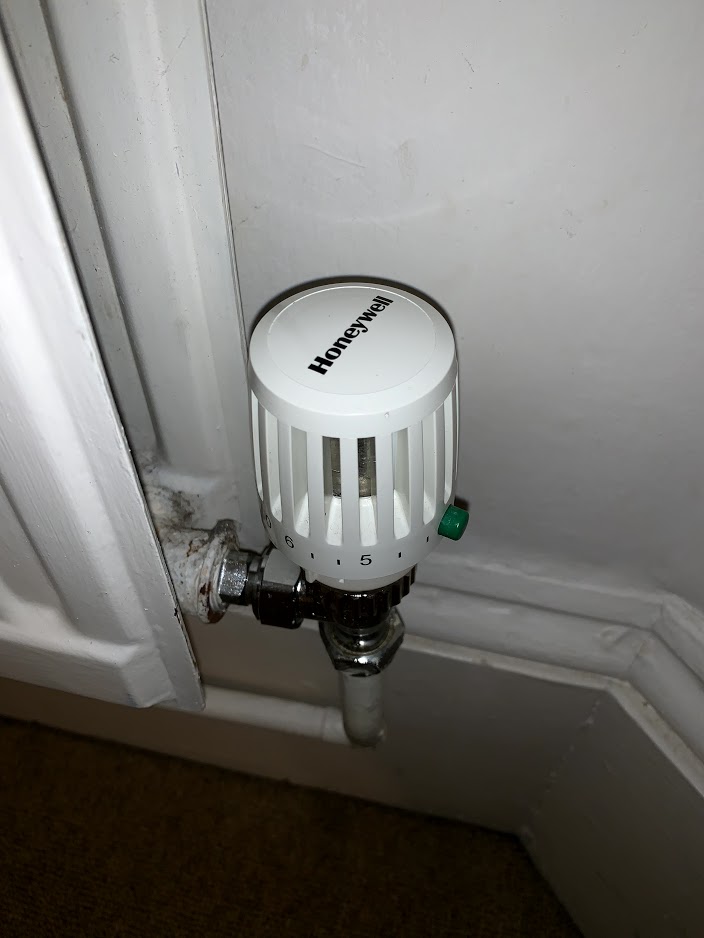

Yup. Two pics of the isolator, one with cap, one without, plus one of the TRV, so you know what's on the other end. This is the one in the living room (working fine today). Several upstairs are similar. No nipples to twist.

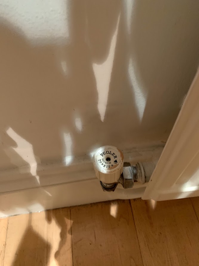

One. I also have a Drayton TRV, a Regis TRV, and a 4th that looks like the Honeywell but I'm not sure because it's somewhat hard to see (behind a chest of drawers).
Six rads total in the house. Four TRV. Two manual.
