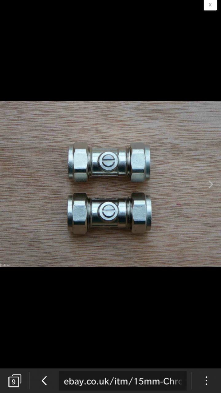

Or alternatively if you see any of these. Isolation valve. Give a 1/4 turn (with a flat screwdriver)..and this should turn your water OFF @ only that application, and assist you in completing your task.
And afterwards...
Don't forget...to
Give another 1/4turn ..
To turn the water on again..
