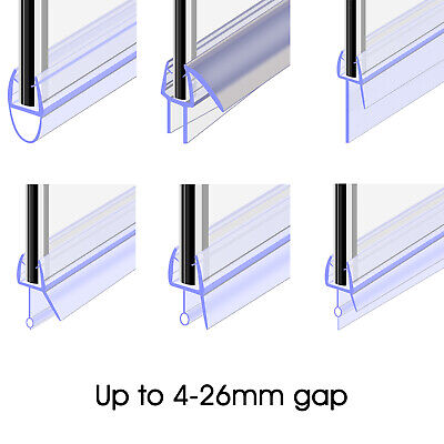

The issue I am finding (buried in reviews) is that the seal often doesn't go the whole length, so a perfectly-fitted one will still leak:
(there was a review that showed a 10mm gap, but I can't find it)
So, even if I get it just right, it is still going to leak. Problem is that I can't go round and check them in person and none of the online photos are good enough to see that area.

In the end, I went for the £80 Screwfix Special and it seems fine for the price: it's not going to be found in a reclaimation yard in 100 years, but it should last me long enough.
They key thing is that the plastic seal at the bottom is user-applied - so I could make sure it was fitted correctly and it can be easily replaced at a later date.
As a bonus, it uses the same-sized mounting bracket as the existing one - which was the only thing competently-fitted by the original bathroom installers - so I saved a lot of time and I knew that it was already correctly positioned and aligned.
Removable seals get dirty rapidly. I prefer to support glass with small wooden wedges at each end so creating a 4mm air gap. Fill gap with clear silicon, no air bubbles then smooth edges so perpendicular. Leave for 2 days to set. Remove wedges and weight of glass compresses silicon slightly. Fill gaps left from wooden wedges. Even weight distribution, always clean, bombproof.
