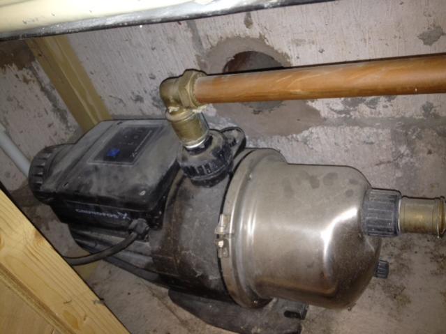

Second of all it sounds like a booster pump of some kind. I can be specific as it is a Grundfos and they have made more pumps than there are rats in the world
Do you have any photos or model numbers.
Photos will be better as there may just be a simple install fault
Thanks for the reply. Photos as requested 🙂

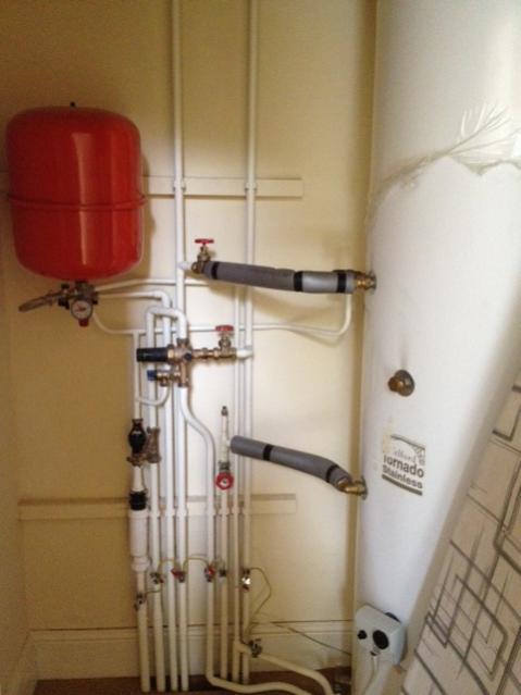

I've taken some of the airing cupboard, in case that helps identify the type of system. The noisy pump is the large one in the 2nd photo.
Wow you must have a large house
You defiantly have a boosting pump.
Do you have tanks/cisterns in your loft?
You can have flexible connections onto and off the pump to help reduce noise
You can also raise the pump slightly and put a special mat underneath to also help lower the noise level
It will also be worth having a good plumber give the pump the once over. The bearings may be on the way out causing noise

The 10second start will be due to a leak or faulty check valve in pump

You have A Grundfos MQ3 booster pump feeding an un-vented hot water system both have expansion / pressure vessels within them these need testing & re-presserizing from time to time (the un-vent cylinder should be serviced once a year with the boilers). If these are flat it can lead to noise when in operation.
Make sure the plumber you employ has both the un-vented ticket & is experience with larger boosted water systems.

Thanks Chris, that's given me something to help find a plumber that will be able to sort it. I checked the red pressure vessel next from the first photo and it reads 0.5 Bar - not sure if that indicates anything.
It's the gate valve on the horizontal pipe that goes into the pressure reducing valve and then feeds into the bottom of the unvented cylinder.
The 0.5 bar is the current pressure on your heating system, I would think it should be nearer to 1.0
No, red one is for the heating & nothing to do with booster or hot water but likely that 0.5bar is not enough for heating system, how many floors of the house above the red vessel??
Both the H & C are shut down using the stop valve next to the tun dish, below the red vessel, unless there is another valve on the hot water outlet of the cylinder.
Sorry Simon the gate valve looks like it is on the balanced cold water connection from the combination (PRV) valve to me ? the one facing downwards (outlet) looks like the cold feed to me??

Cheers. It's a 3 storey house with the cylinder in the middle.

Heating pressure should be OK between 0.5 & 1 Bar as there is likely to be around 5 Metres of water in the heating system above the vessel (1 Metre = 0.1Bar).

While he was there, he took a look at the cylinder and I mentioned that the tundish was dripping every other second, so he's going to take a look at a few of the valves to see if there is a leak.
He happened to lift the lid of the cylinder and noticed that the expansion vessel felt wet - there was condensation all over the lid too. So he thinks that there could be a leak somewhere on the cylinder and it may need replacing, as it should be bone dry. It looks like there may have been a leak at some time previously, as there is some staining on the ceiling under where the cylinder is. I looked at the expansion tank on top of the cylinder and happened to notice that the date says "2011" on it - but the cylinder was fitted in 2005, so I guess that some previous work has been carried out. The house was rented out while the previous owner had it, so I don't even know if he's aware of this - but I'll try and find out.
Should the MQ3 booster pump run when I use even a tiny bit of hot water from a sink tap? I would have thought that it was only needed when large volumes of water were required?

yes, both need to be check & adjusted to suit the pump they can both act as storage &/or expansion vessels (or not is they are flat). The pump should not be starting on any small amount of water usage.
