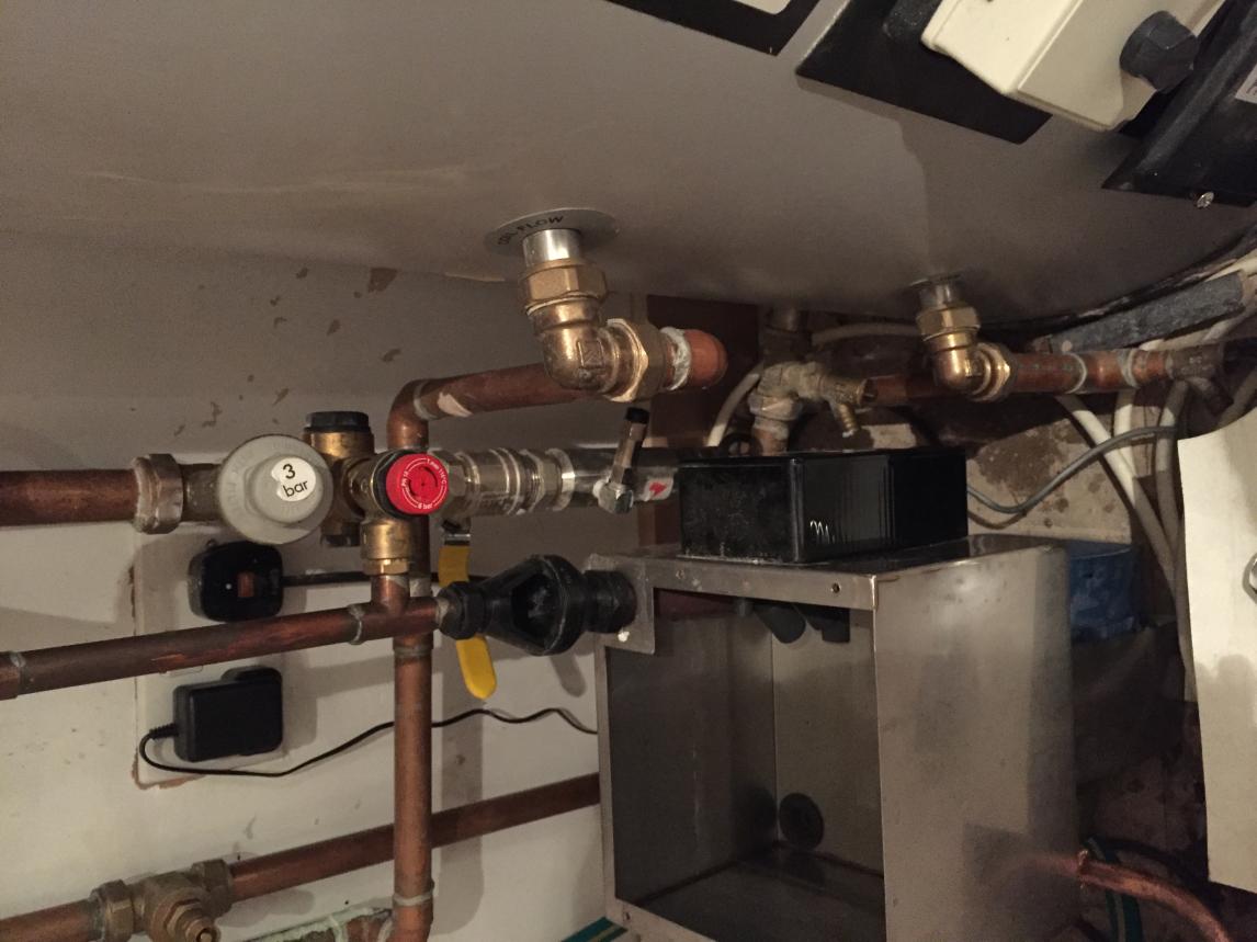

Hi guys,
Just thought I'd follow up.
I think it is the internal bubble and I need to recharge it.
I watched a few videos on YouTube and it seemed easy enough but unfortunately I think they related to Megaflo systems. I think on mine I actually need to get a pump and pump up the Schrader (see instructions attached).
I know how to drain the tank and open the PRV but would one of you kind gentlemen point out where the schrader valve is please and explain how I would open the "shut off valve"? I have attached pics to refer to.
Thanks again guys!
Ryan

Ryan, it seems now you DON'T have a Megaflow, or any other internal bubble unvented unit!
You must have an external expansion unit, which is entirely a different story. You cannot work on those unvented units, in any way, unlike the Megaflows air gap replenish.
Forget about doing anything yourself. Certain tests and pressures need carried out, which is a normal part of a yearly service. Get whoever installed the unit or any G3 qualified person to service the unit as it is the law. Keeps the unit safe and the paperwork done for warranty of normally 25years.
There are 2 different types of your system If you don't know the difference or know what a big blue orwhirte expansion vessel looks like spend 50 or 60 quid phoning some one wh does.
I was going to say phone a friend but unfortunately if you live in city you are unlikely to know the guy next door never mind your local tradesman. Such is the modern world and don't trust checka trusted whatever cos they are shyte and only collect cash from desperates
While your Part G engineer is on site & the system is drained they will also remove & relocate the isolation valve that should not be there.
It really isn't worth playing around with these potentially dangerous systems if you don't know what you are doing, Ryan
At least for the first time, once you have seen it done & the system is corrected, it might fall under a user operation.
As per Tamz above, do your research & ask to see their Part G / unvented certificate.
The instructions on cylinder and external setup of pressure reducing valve and pressure relief valve do not appear compatible from your photo. This alone should warrant the attendance of a G3 qualified technician.
