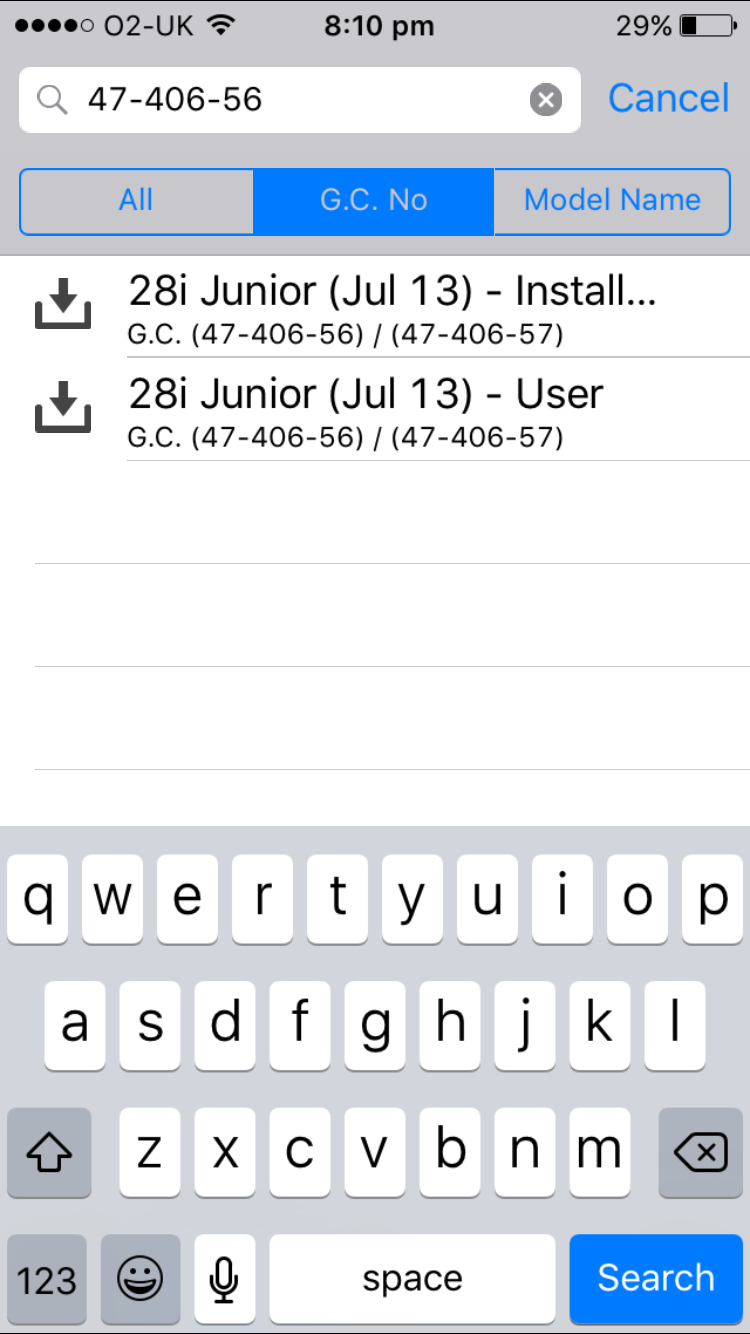

This like the one you have ?
Worcester do do a fixed price repair so might be worth going down that way
Hi ch4
thanks thats the one is it the same gc no. I ws getting a different manual....
Eddie
Thanks all
I could only find the customer copy for the junior which apparantly has the same GC no as just the greenstar which was all i could find on service installation and commissioning part of MIS. You think the two different models woukd have a different GC no der. Thanks ch4 I know what you mean about getting Wb out on a fixed fee and think that might be the way forward but it is bugging me as to what could be the issue.
Eddie
i wouldnt mind some pages shaun do you subscribe to a site tht supplies them or was it a google search.
Eddie
