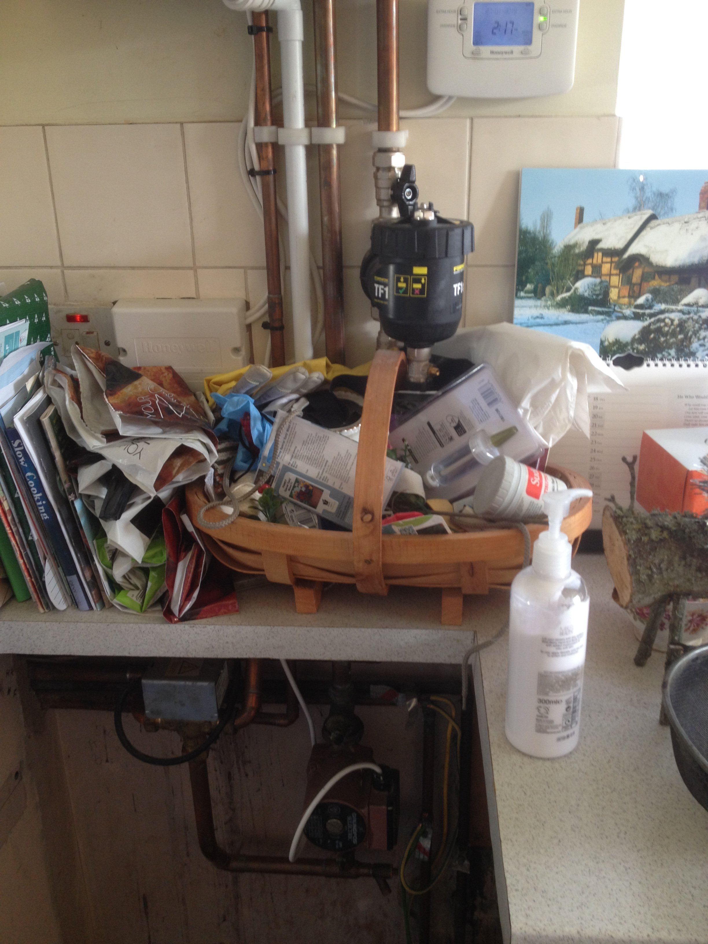

Hi! My mum has not long had a new boiler and instead of it being on the floor it has been mounted on the wall with a magnetic filter under it. I wanted to move the filter further down the common return so I could box it in. I have moved radiators before as it is a vented system but as the filter is so close to the boiler I was wondering how you would bleed the air out of it after I had moved it. Do you just bleed though the radiators as normal? Is this a job for a plumber? Please see pics.

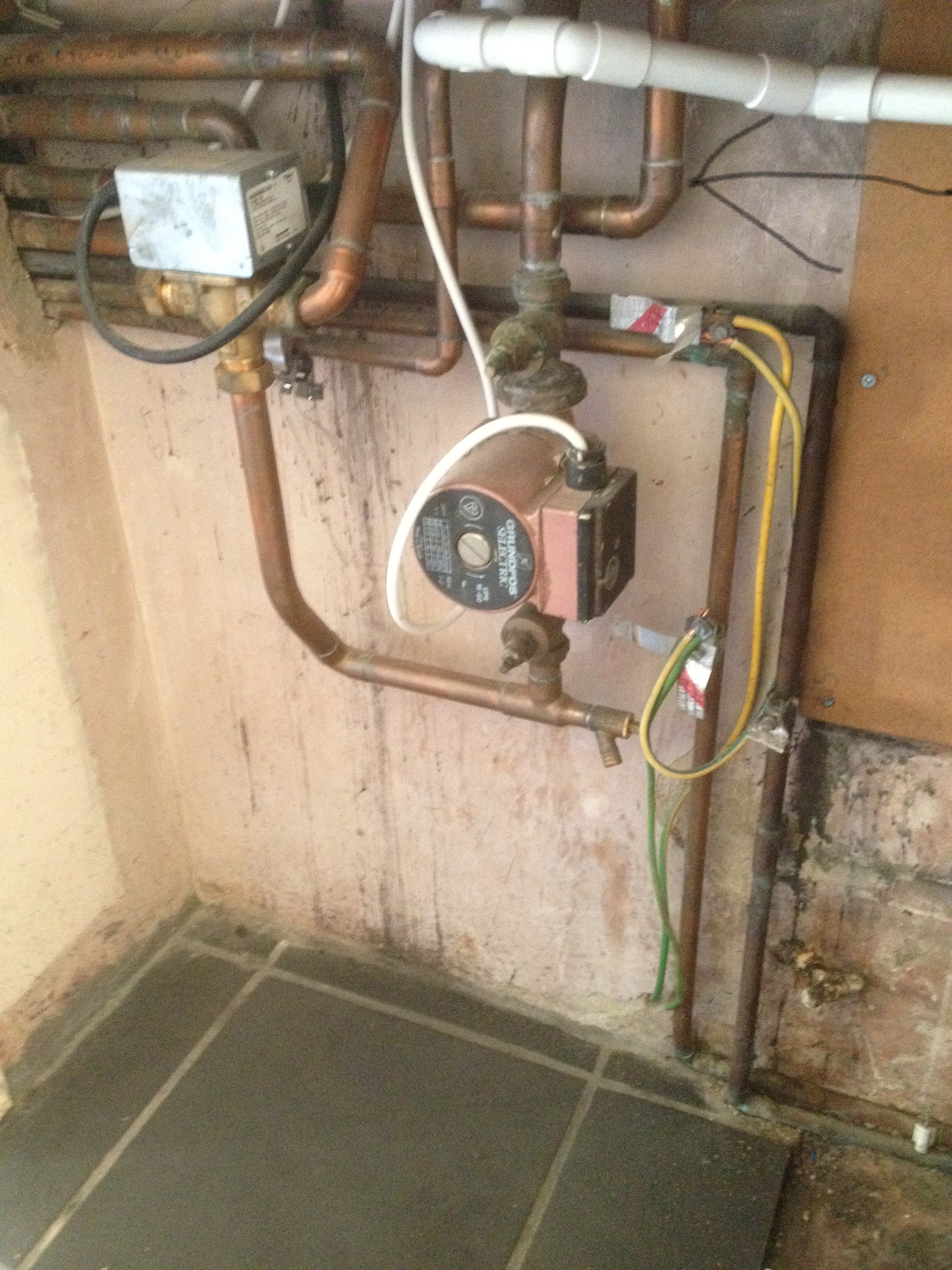

It's a job for someone competent, if your competent then go for it. There's likely an auto vent in the boiler so if the enginner left it turned on (which most do) the boiler should vent itself. What boiler is it? I'd change the pump while your drained down. That pumps at least 20 years old and I can't believe the enginner hasn't swapped it when fitting the new boiler 😕

Sore subject mate my mums old and doesn't understand. That pump should have been changed and it was done by a contractor of a popular gas company, she paid over the odds for it and we have been left a bit disappointed to be honest. Thanks very much for your advice. It is a Worcester boiler.

If i drained down the system but closed all the rad valves so the rads didn't drain down would this be ok? Or would it cause bleeding problems when I go to refill?
Assuming its a Worcester RI series boiler, heat only, then no the boiler does not have an auto vent inside. You can vent the heat exchanger but that is inside the boiler, which requires you to be gassafe.
Leave it, yes it's a bit of an eyesore but that'll soon pass plus reconfigiuring the pipework so you can attach the filter lower down isn't work for an amateur.
