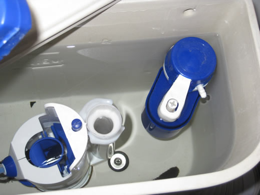

My toilet keeps running.. that is.. once I flush, the cistern empties into the pan, then once the cistern is full again, it keeps filling (slowly) and the water runs into the over-flow thing. (it is a push-button toilet)
mytoilet.jpgThe blue round thing in the middle has often got "stuck" up in the past and not allowed the water to fill the cistern, but instead continuously flowing into the pan - this is not the problem now.
The problem now is that the blue round thing in the middle is down all the way, but the water keeps coming and flowing into the overflow thing - the round white item tube to the right.
Right says me, maybe the overflow thingie is too low, so I edged it up higher - no luck, the water then just came in more until, once again, it hit the overflow.
Now there's some kind of blue thing on the right which has a plastic adjustment screw on it, when I turn it the blue thing goes up and down. This seems to have no effect whatsoever on the running toilet or the water levels or whatnot.
Does anybody have any idea what's happening?? Do I need to buy a new something? maybe a seal? Is this something I might be able to do myself without flooding 1/2 of London?
Thanks Kindly for any assistance anybody can provide.
The float valve is not shutting off!
This could have some debris inside it, or worst case you will need a new bottom entry float valve
Try dismantling the valve and checking the washer is clear from debris...

mytoilet.jpgJust to clarify, this is to replace the thing in my photo that's on the right side right? .. the blue thing with the adjustable screw on the top which doesn't do anything when I turn it.. right?

yes its the part on the rh side you can get the bottom entry from screw fix,just not showing on there site failing that go to your local pts

a tip there will be a bit of water left in the cistern when you drain it to replace the valve turn the part in the middle this will remove most of the water use a sponge to soak up the rest,get a new fiber washer for the swivel as well(the bit that screws on to the ball valve)

You will be best off to isolate the water to the cistern, strip out the valve as has been mentioned, take the valve with you to a local plumbers merchant & not a diy shop, Plumb-centre, PTS, Travis etc, they will match the valve or give you the best other option & also ask for a fibre washer while your there...they deal with these things every day & will be able to sort you out no problems.
well.. I got my fluidmaster pro and my fiber washer from the local plumbers merchants - figured out how to turn off the intake to the toilet - (no tap, had to turn the screw!) - now I'm just finishing my lunch before launching into my first diy plumbing experience! cross your fingers for me!
Well.. it's done.. and it seems to work a treat so far!! Thank you so much for all the very helpful hints!
I got the fiber washer in - funny there wasn't one in the old valve model, used a sponge to get the extra water out, as suggested.. couldn't have done it without you all!
Also.. I noticed that in the old valve there was a "valve flow regulator" fitted into the shank of the intake valve.. this explains so much.. it's always taken ages for my tank to fill - I am NOT in an area of high water pressure - or if I am - it's irrelevant because the toilet fills from the attic cistern - which is decidedly very low pressure.
I chose not to put the valve flow regulator into this new one.. and the toilet fills blissfully quickly by comparison!
The only thing I need to keep an eye on is the seal on my connections - which I had a hard time getting to not leak - and I'm not sure I've completely succeeded - I may need to tighten them further, but I'm afraid of over tightening .
