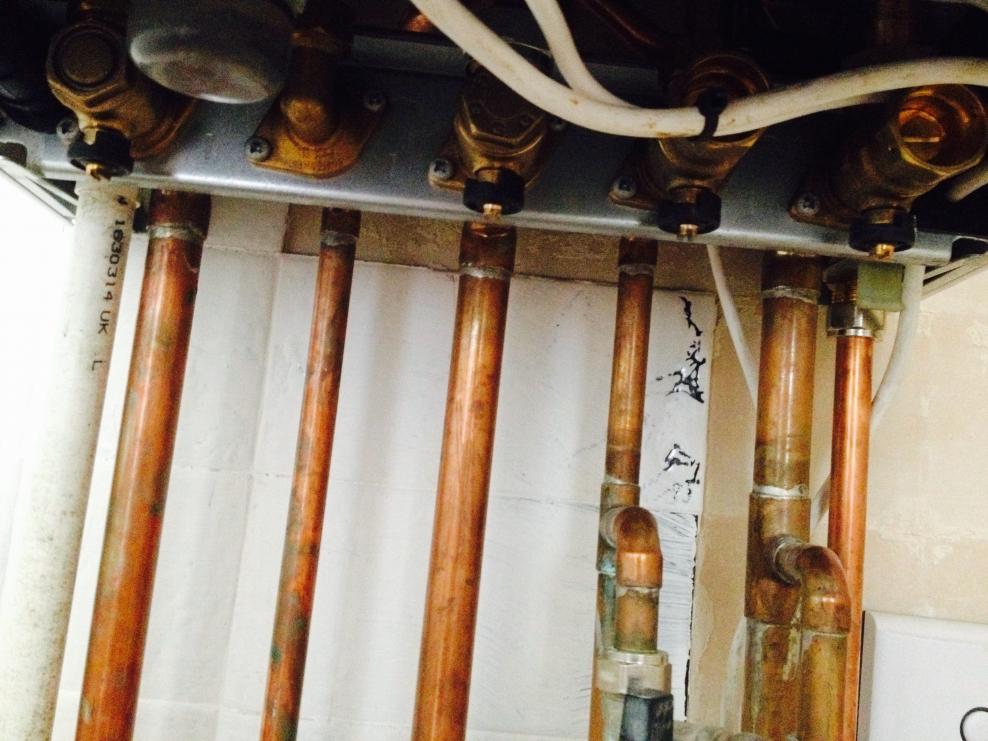

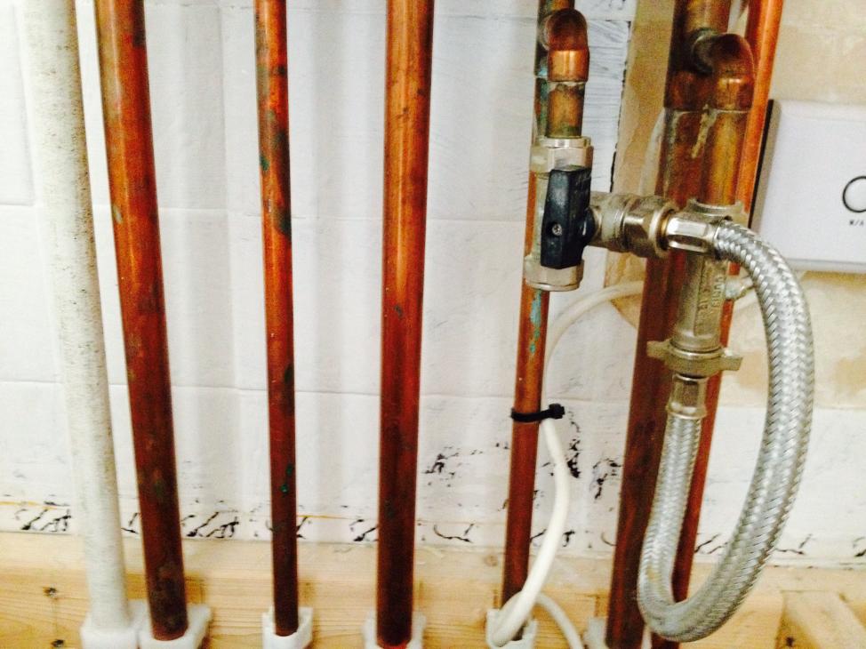

Hopefully these upload ok, if not I'll try another way. It all looks quite dry in there! Smell seems to be just after running hot water though, showering for example and when I do the dishes?

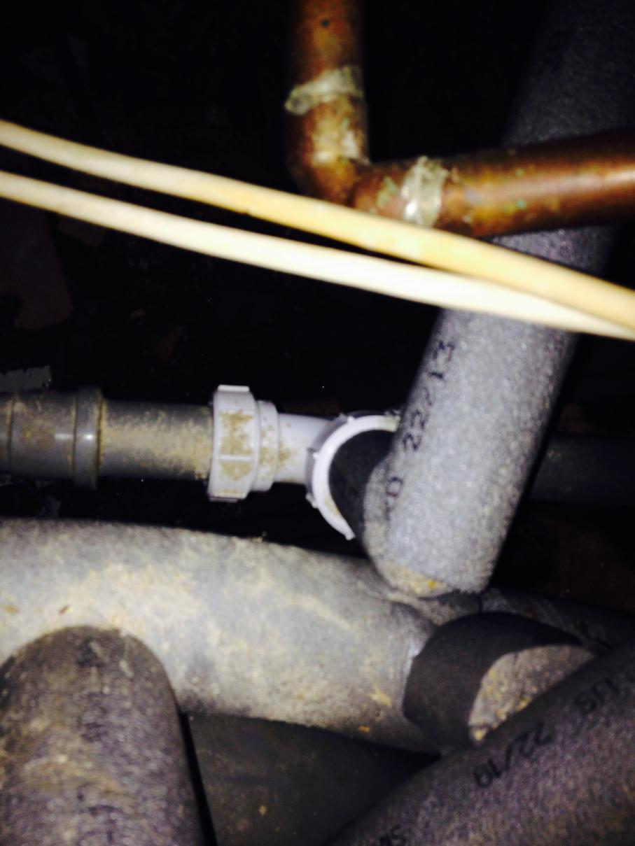

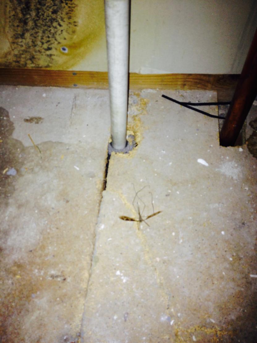

I've lifted that bit of chip-board flooring and had a look. There are a lot of pipes all in grey protective foam, and below that it looks pretty damn wet down there, although no overpowering smells or anything.

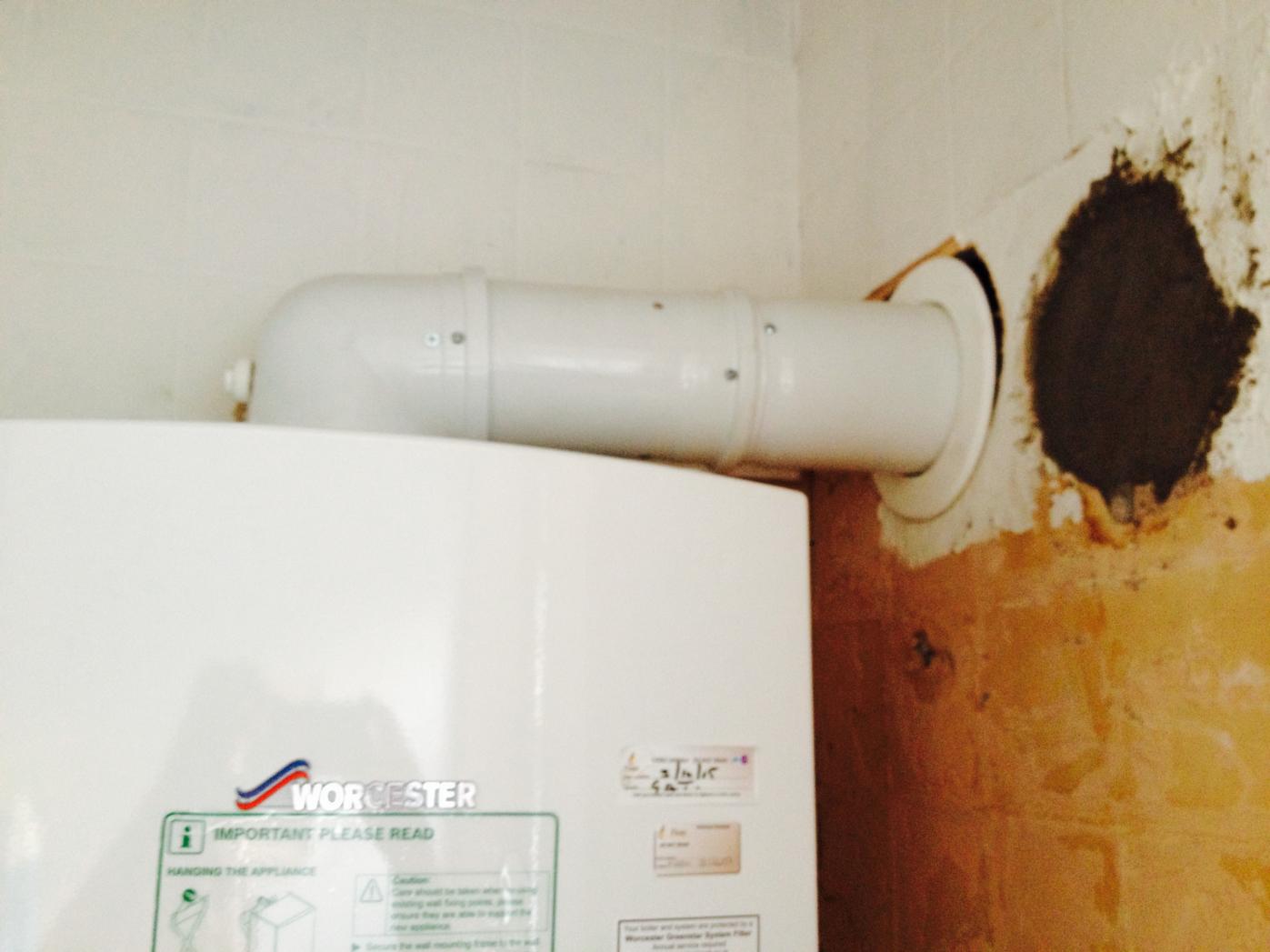

as to where the white pipe ends, it might be outside the house? There are two pipes on the back side of the house but in terms of whether they are this pipe or not I can't be certain. One is bent like a shephard's crook, the other is just a little white pipe poking out a few inches.

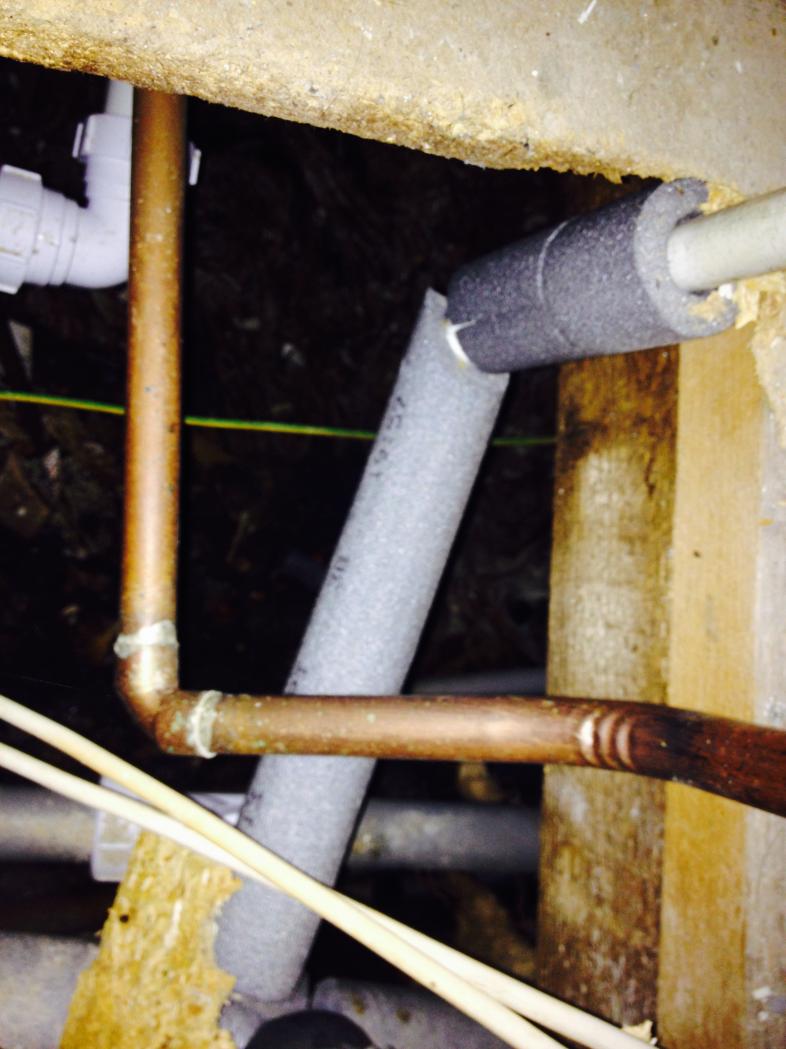

Is that just earth down there (under the floor ) and any chance of seeing if you could get a pic of the termination of the White pipe into the waste ?? ( white tee) Thanks
Looks like a waste pipe is discharging straight under the floor,! Shouldn't be that wet under there.
It looks like it might be concrete and leaves (Where they have come from I'll never know) at the bottom. The termination of that white pipe goes into a grey one that goes two ways (one way would appear to lead into the kitchen as that is the next room and the other room where the smell comes by the way). I've been outside the house as there is a cubby hole just under the kitchen with a door, but the wall of this ends with the kitchen wall so I can't see backwards into the bathroom, and by the looks of it there's no way to really get a closer look.
The position of the boiler is inside a cupboard in the bathroom that is raised, so I can't reach down far enough to get the grey foam off the pipers for a better look.
What I will say is if that grey pipe leads somehow through the kitchen, in this cubby hole under the house there is a pool of water we assumed was from flooding in Feb time - I don't know if that gives you any clues. I did get as close as I could without falling in! Once my fiance is home he can give it a go as he is much taller than me (6ft 5 compared to my 5ft 2!)
The white pipe terminates into that lighter grew one that looks like it has two screw ends on either side.
