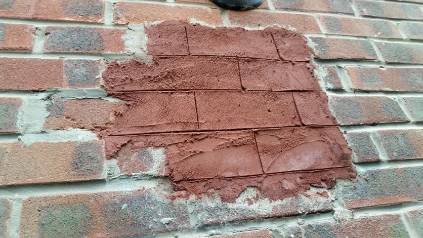

New boiler fitted, part of the install was to brick up the old flue, prior to the job starting the plumber asked;
'Do you have matching bricks for the hole that will be left, or he can bring his own but they won't match the colour of your house bricks'
My reply - 'Bring bricks anyhow, but I'll try and get some'. Seems quite clear the job involved bricking up the old flue
This is what has been done, advice please! Is this a suitable fix? This is concrete with lines drawn in to look like bricks. The fitter has since stated 'Well, I'm not a brick layer'
I've since been quoted £275 from a brick layer to put right
That is brilliant!!! Sorry to mock but that's awful. One of those you have to laugh or you'll cry moments
If he's not a bricklayer then he shouldn't mess with brickwork.
This must me the first ever floorstanding to wall mounted he's had to do.
He needs to find himself a bricklayer for future jobs.
P.S it's not concrete it's mortar, it'll fall out eventually with frost and rain attacking it.
You could find a local graffiti artist and see if they could do something with it.
It looks like he's thrown it off a shovel at your wall.
This is one of the differences between prices on jobs.
Just out of curiosity, did you choose the cheapest price ?
I know we like to take the mick but the prv and the level condensate look a bit suss that said he put more clips on than I do
On a more serious note, I would ask him nicely to replace those and make it good.
If he was not up to doing it correctly, he should have allowed for a bricklayer to do it.
View attachment 27888View attachment 27889
275 from a bricklayer to put right... Seems a lot for half dozen bricks & some mortar! Shouldn't take too long!

It has been siliconed in - there is NO strap on boss, I've queried this and been informed it's down to "personal preference when to use"
I thought it was quite expensive too, however this is the 1st quote I've been given
