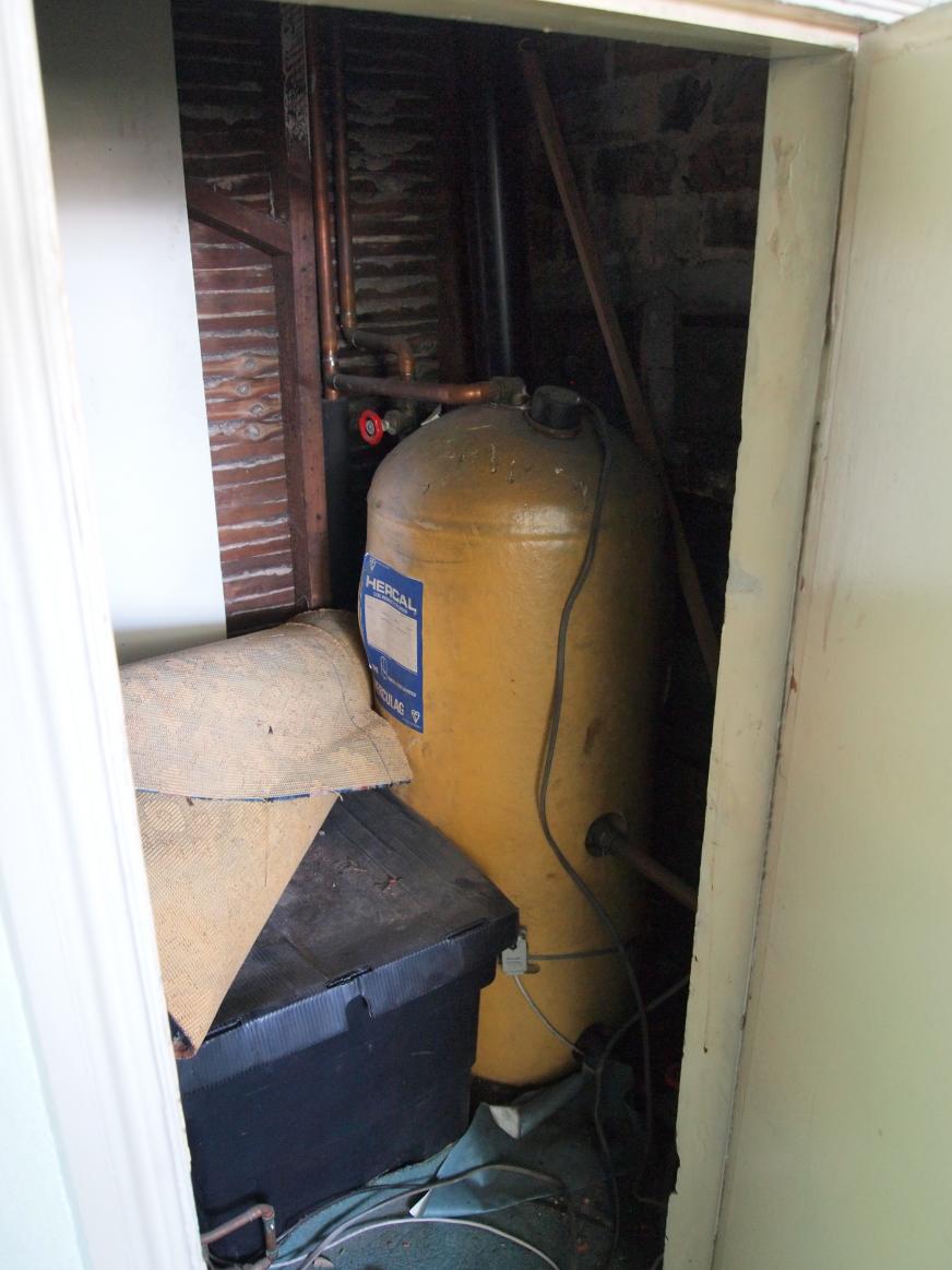

New to the forum - new to plumbing and also new to home ownership and am hoping for a bit of initial help to get me started. We've almost completed on our first house.. a large, victorian terrace in need of a lot of modernisation. Currently, there is an old, floor standing marathon 40 boiler on the semi basement, and the below (hot water tank, small cold water tank) on the 3rd (there's ground, 1st, 2nd, and 3rd floors) which is an original floor built semi into the roof space. I don't yet know what's in the loft above the tanks you see here - but I'm assuming that, there will be a larger cold water tank above? If so, what's the tank next to the hot water cylinder for?

Hi Greg,Welcome to the forums,difficult to tell the state of play in your photos,i would suggest you look at our i need a plumber section on here ,post your location up and one of our profesinal members can advise further
I would intitially think that tank at side of hot cylinder is a secondary cold tank supplying separate bathrooms or other.
You really need a heating engineer to take a good look at everything. Obviously that hot cylinder is fairly old, - I would think we'll over 20 years and you will be better replacing everything usually if you can afford.
You need to first decide if a stored hot water system is best for your needs and consider an unvented cylinder system if mains supply adequate. Or you could have a new pump doing showers or more

With a new unvented system would give you mains pressure stored hot water.
It's near impossible to comment on the scale of the job without seeing it in person.
The water tank could be a break cistern if it's supplying areas which could contaminate the water main.
As gas man suggested, post your location up and hopeful someone from here would be able to come and have a look and give you some advice.
