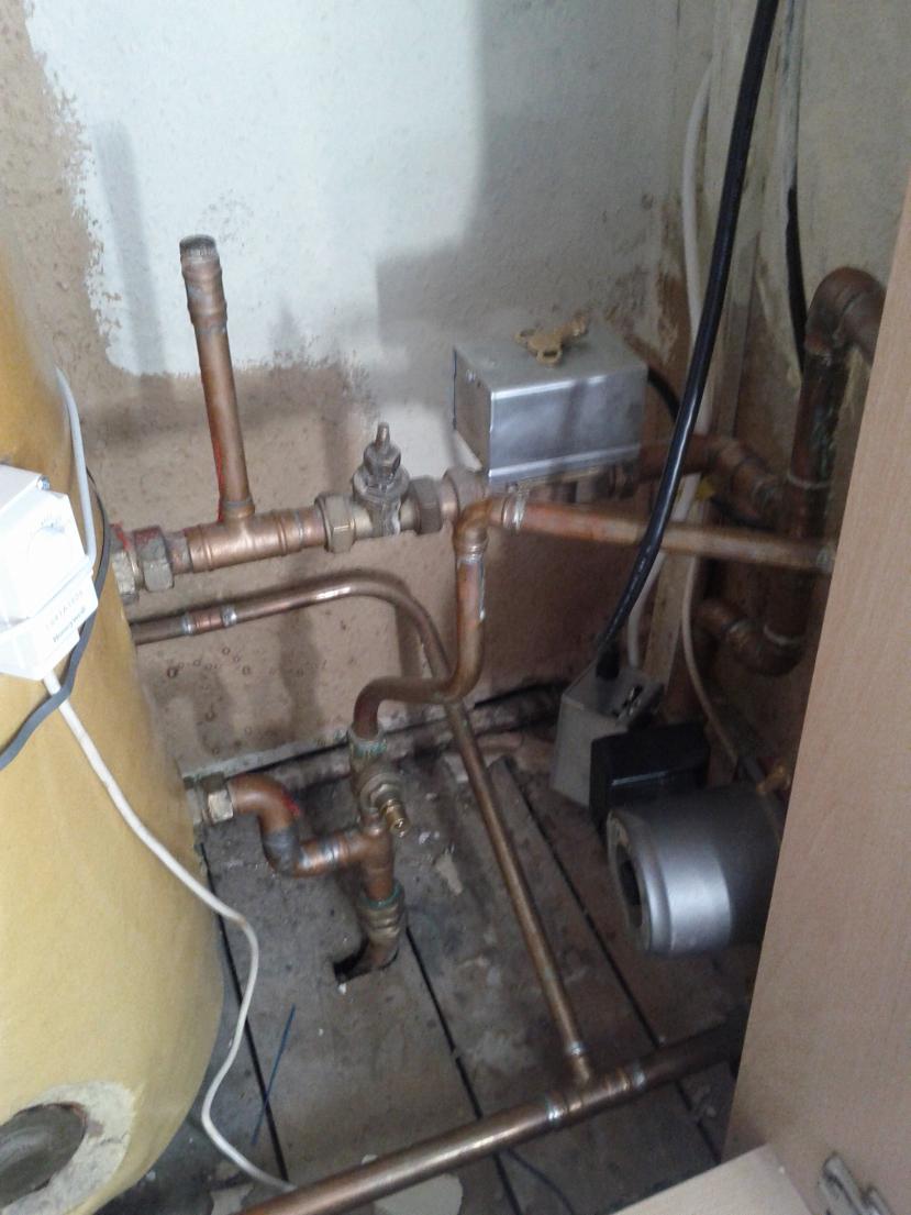

Any chance of a picture Mark? Or is there 2 or three pipes attached to the valve in question? If two pipes there's a problem, three then it's working correctly 🙂

Should we leave the radiators turned on then but knock the thermostat down to zero? Baby is sleeping in the relevant room at the mo, but I'll post pics/video of the setup when possible.
Please find some photos of the setup attached. Hope they make sense to someone! Let me know if further clarification is needed.

Honeywell 2-port valves. Have you tried moving the manual lever across on the valve that controls hot water flow from the boiler into the tank?
Also, when was the last time you vented the system from the main vent? I presume that's why the radiator key is handy on top of the valve near to the vent (vertical pipe not connected to anything)!
You've got an S plan. The hot water should work brilliantly with the heating off. You've either got a faulty component or it's wired wrong. Naff all to do with the size of the cylinder. get a heating engineer in that understands system wiring/fault finding and they'll sort it.
M.Joshi: I tried moving it in the past but met with resistance so thought it shouldn't be touched. What is the difference btwn auto and manual as it says on there? Also, only ever bled radiators - anything else is new to me!
You will meet a little resistance when pushing the lever across to manual. There is a tiny hook which you push the lever behind to stop it returning back (spring return). Normally when the system is wired correctly the actuator (if working) opens the valve automatically. The lever allows you to manually open the valve and let hot water flow from the boiler through the cylinder coil. The valve you should be opening is the one with the radiator key on it in the picture.
When you have water flowing through the cylinder coil, you can open that vent (vertical pipe) slightly with the radiator key to let any air in the system out.
It does seem as though you have perhaps a stuck valve/actuator or loose wiring somewhere.
P.S. If you PM one of the moderators for this forum, they should be able to delete the previous post.
Hi just seem photo's of your cylinder !it looks like the cylinder stat is to high up ! needs to be about 12" from bottom of tank, yours looks more towards the top (Hot Area) try relocating stat lower down (Cold area)
Good question Gray, maybe he could put a better photo on here showing cylinder stat, but it looks like it is just strap'd on tank !!
it does look like the stat is on the surface of the insulation, therefore serving no purpose, causing questions!
it could even be wired backwards
the only real solution is for someone with a multi meter and an understanding of the controls sequence to run the checks and see what is happening
Just looked at this thread.
I agree that the cyl stat is in the wrong position, it should be 1/3 of the way up the cylinder from the bottom.
Disagree with the speculation that the stat is not cut into the insulation being the cause of the problem.
If the stat can't sense the temperature in the cylinder then the water will just get hotter until it reaches the boiler set temp.
No the stat not being cut in to insulation won't be the problem just fitted by a muppet so if they can't get that not right god nows what the problem could be
Sounds more a control problem than a plumbing problem
But impossible to be certain without seeing it IMHO
