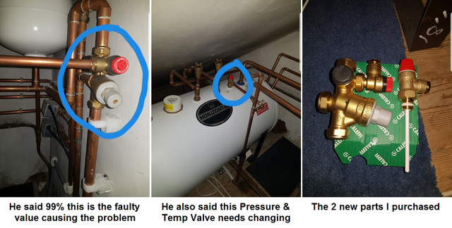

Hi, hope someone can help. A few days ago I noticed that the hot water was not as hot as usual and the overflow pipe outside was pouring out water like someone had put the tap on. This was more or less continuous for the duration that the hot water was switched on.
Had a plumber who came out that evening and after some diagnose said that 2 parts need to be changed and told me to get the parts (which I ordered) and to let him know once I have them. He also turned off the water as he said it’s not safe to leave it on. So the only running water I currently have is cold water in the kitchen sink.
He said 99% that the Inlet Control Multibloc Valve is faulty and to also change the Pressure and Temperature Relief Valve.
Now it looks like the plumber has gone AWOL and I’m unable to get hold of him!!!
Before I get someone else in, can anyone knowledgeable confirm if the advice he has given me is correct, in that both parts need to be changed to resolve my problem? Thank you.
This can’t be diagnosed from photos and description, also it’s also forum rules and the law that anyone working and unvented cylinders be suitably qualified, so as per Shaun, this is G3 registered (certainly in England and Wales). Therefore we cannot confirm if these are the parts required.

When I spoke to him on the phone and explained the problem (and told him I have the two parts) he said he thinks it could be the thermostat on the cylinder that's gone. Will know for sure once he has seen it.

Er , I doubt that but lets hope he knows what hes doing .

Had a G3 reg plumber come round yesterday and he replaced both parts that I had purchased (he said the pressure and temperature relief valve appears to be okay but changed it anyway as I had bought the part). He also serviced my unvented cylinder & my boiler (valiant).
