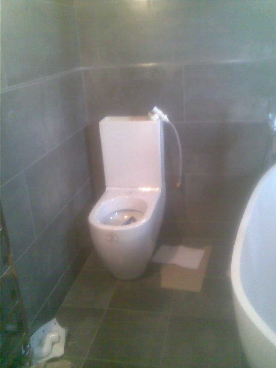

not got a clue how to plumb in with the adapter/isovalve MI are usless..
Any ideas..

I think that might be a dry wall filling kit . Valve head sticks out through wall ( I think your photo shows valve head, its a bit blurred) the rest is all concealed and then pops out to the fill valve through large hole in back of cistern.
I had the WC apart in Rome in Feb 🙄saddo
The two holes at the top of the cistern are for the entry of the supply.
Fitted a smillar Catalano pan not so long ago and fitted a 15mm x 1/2" bsp back plate elbow in the wall in line with one of the holes. Once fitted the flexi on the float valve can then be screwed into it. Job done.
I had the impression that was where/how the inlet was configured but where does the float valve go as it is on the end of the flexi!
Looks like a side entry type , does it hook onto the syphon, got no pics in the MI to help.🙁
Now all i have to do is re route the cold supply to the top, not to bad...now that it is tiled 🙁
