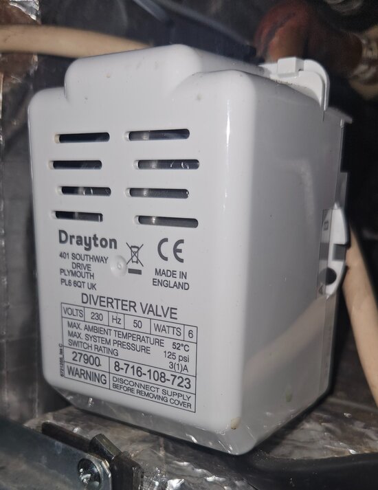

Hi, this is about my own boiler. I'm a new-ish plumber but no boiler experience.
It's a...... Worcester Greenstar Heatslave External 18/25 Oil Boiler
It had a new burner and was serviced at the end of December 2024, and I've just re-pressured the boiler and it's expansion vessel to try resolve the issue.
BUT, for a few weeks now, when we run the shower, it comes on warm/hot for a few seconds then turns cold. Then we have to keep turning on and off, getting hot then cold water each time. It only stays hot after maybe half a dozen times, sometimes more. It's getting quite annoying now! No other plumbing in the house has changed.
Anyone know what the problem is and the solution?
Well it does, but on and off for about 5-6 attempts until stays on!
What about heating does that fire eg not attempts for 5 etc
[/QUOTE]
Obviously it's been off quite a while, but just called for heat and got hot straight away, so don't think its a problem.
Btw, same happens at hot taps as well as shower, so not just the shower, that's prob obvious but thought I'd explain anyway.
[/QUOTE]
Prob cold water ntc
