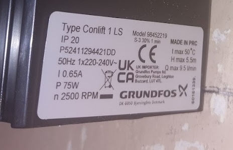

Here are details of the pump itself:

Sounds like the pump isn’t able to pump anything maybe blocked outlet
Might be best to look where it terminates to
Also should be level left to right not sagging down to the right (you tried levelling it to see maybe if the float switch is getting stuck due to the angle ) ?
Thank you so so much! That's incredibly helpful! You are right, I checked with spirit level and pump is slightly wonky so I'll try to adjust it. In the meantime I emptied the pump and it eventually went quiet so that's incredible improvement! Thank you again, you are my hero!
