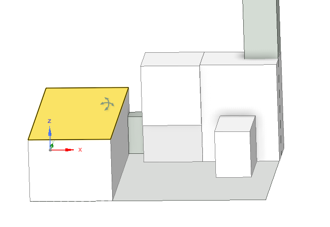

I'm working with an old cast iron stack that has two cast iron bosses built into it.
Currently one has a 40mm waste pipe going in, the other 32.
Thing is they're both 50mm in external diameter and deep. I can only find boss adaptors that are 62mm diameter and ~25mm deep - this one is about 40mm deep.
Any suggestions?

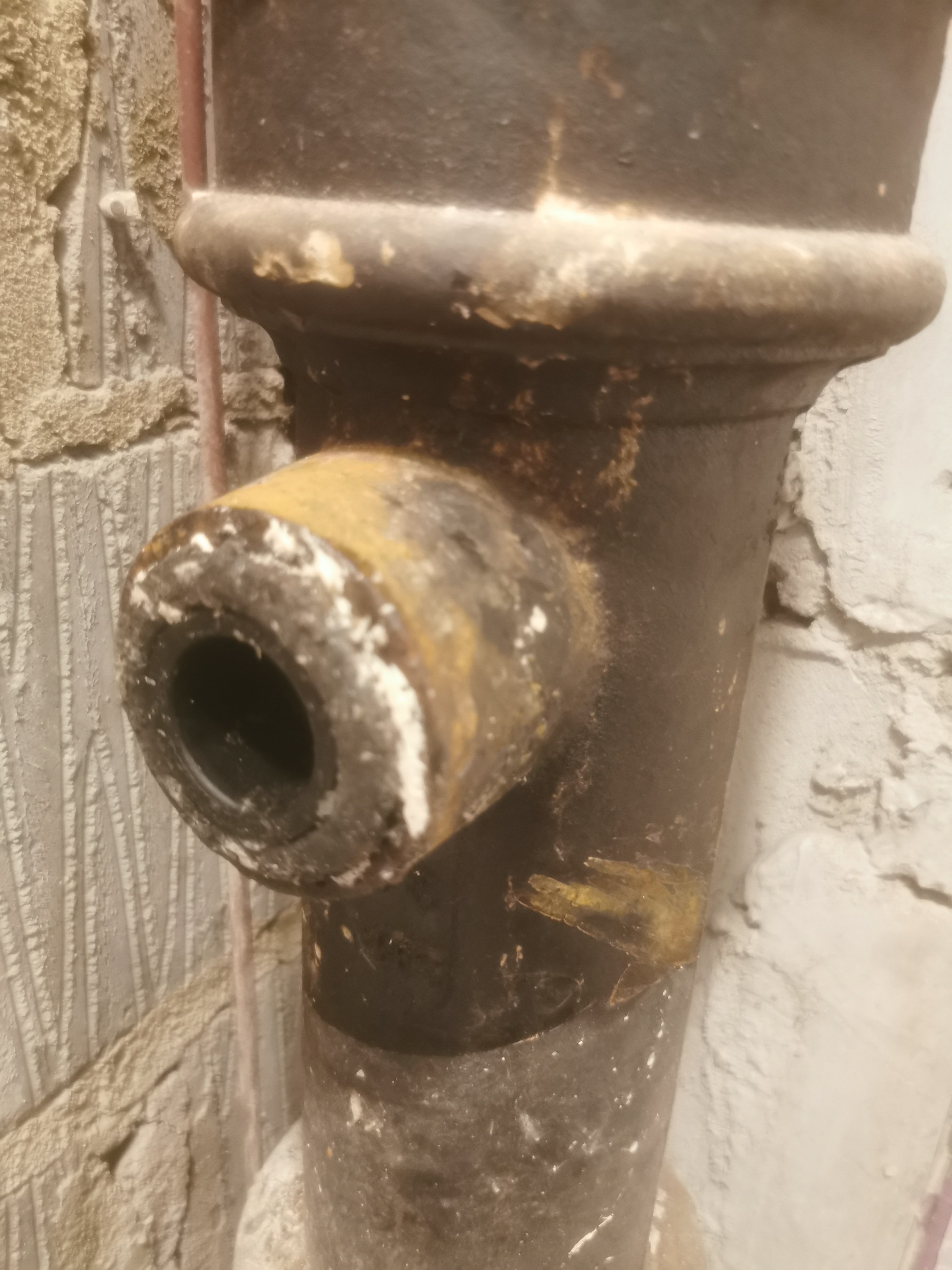

The bosses are built into the main soil pipe - the rubber adaptors are pushed in.
This is a 50's build.
Photo attached - it has a 40mm cap shoved in at the moment.

Any chance of a picture of the collar below just out of frame and a picture of the boss eg in focus / best you can do
Collars are irrelevant really - one below is just like the one in shot - there's another boss just below. I can't touch the pipe itself as it's a shared pipe in a block of flats.
Looks like both were welded to the pipe when the property was built - the hole into the pipe is much smaller than the boss diameter so clearly cut in.

They look like the socket has been removed to me but I could be wrong as the photo is not the best focus.
I have no idea what you mean by socket.
The part sticking out is cast iron - there's a hole into the main pipe at the back which is pretty rusty - don't know if that's just from here, or rust from higher up the pipe collecting in the hole.
There's no thread on the metal work - it's ridged as is the rubber adaptor which is the perfect size for the hole, so this isn't a cowboy job.
I'm really not sure what else I can tell you or show you. I think either you've come across this type of fitting before, or you haven't.

Is the rubber boss still useable? If so, will it except a 40mm waste pipe or a 50mm waste pipe?
There looks to be lead or a caulking between the 40mm cap and the inner edge of the boss on the pipe.
I've seen plenty of cast bossed pipes that were threaded, but never a non threaded one.
They are either 2", 1½" or 1¼" BSP,
The one in the photo looks to be 2" and has possibly had a smaller pipe, maybe copper at the time, caulked into the fitting, it's probably threaded under the caulk.
If not then one solution would be to use a Fernco reducing coupler on the outside of the cast boss(es) and onto the new waste pipe.

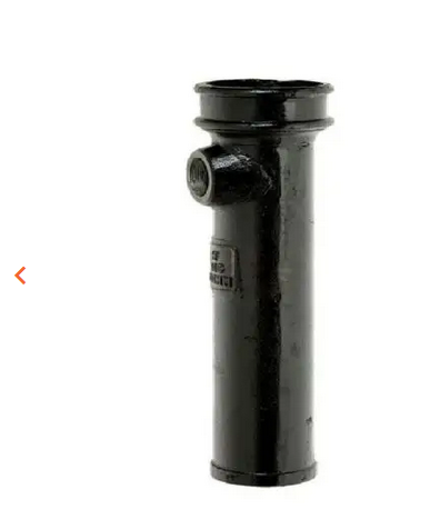

The one pictured won't have been welded onsite they came / come on a short section of pipe as below,

As I mentioned there's two of them - the top one had a 32mm waste pipe slotted into it, the lower one, 40mm.
I decided to put both the sink and bath waste into the 40mm and cap off the 32mm, so I removed the rubber adaptor - it was still dribbling this morning so I took it out again and this time had a real good look inside. Definitely not threaded in there - some chunky ridges, matched by the rubber adaptor. There's nothing else in there either.
In the end I put a ring of plumbers mate at the back and pushed the rubber back in, then pushed a 32mm pipe with a rubber bong pushed into it, into the middle. It seems to be sealed.
The bottom one I left the rubber alone and just put some plumbers mate around the new pipe. That also seems ok.
Sometimes it's best to leave things alone if they're not leaking 😀
