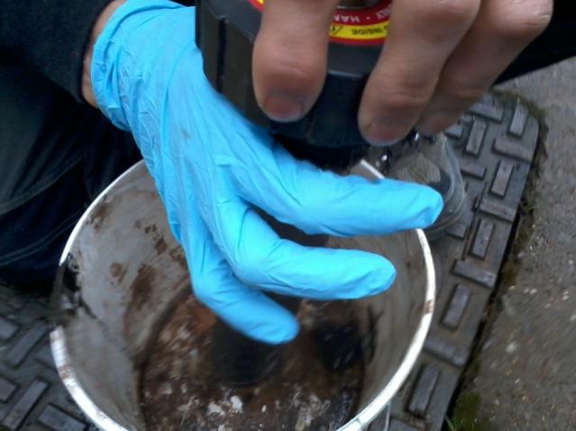

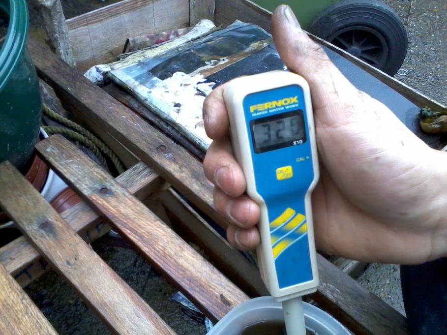

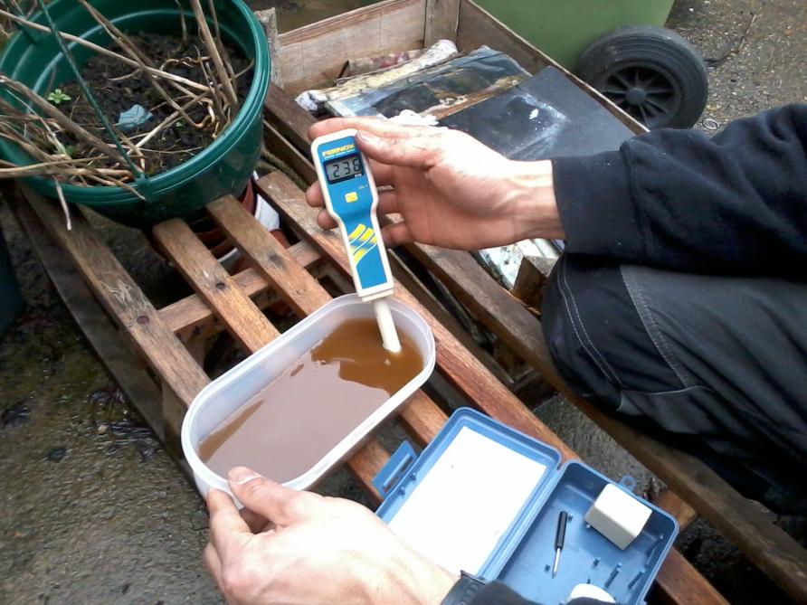

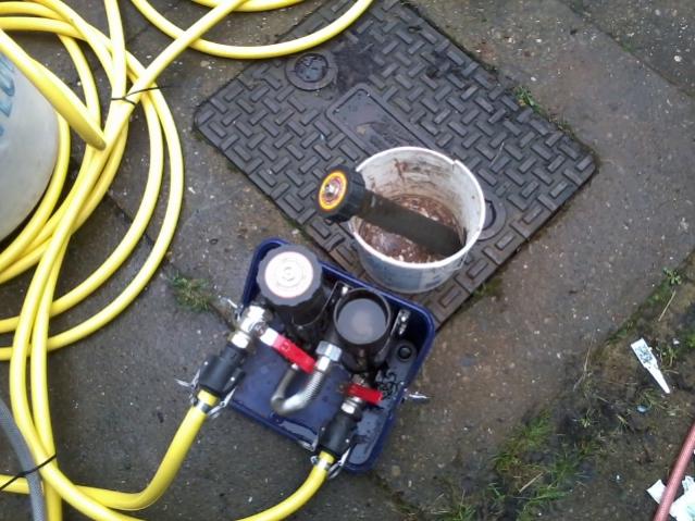

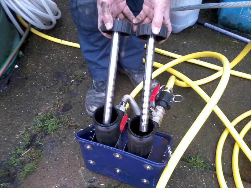

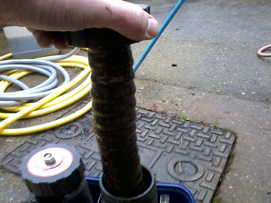

I have a fernox P/F and I have extra long hoses now after I was flushing a system outside the airing cupboard and the son of the customer (in his 20's) decieded to undo the hose clamp!!!!!!! You can get a lot of black sludge along the hall and down the stairs before you manage to turn it off!!!! I now have the machine outside on all jobs Photo0056.jpgPhoto0058.jpgPhoto0059.jpgPhoto0055.jpgPhoto0053.jpgPhoto0054.jpg

thats a impressive set up, were did you get the fernox tester from? and whats the best results you have had from dirty to clean?
Er... from fernox lol.
I always test the cold water at the kitchen sink and always get within 10% of that in line with fernox instructions.
lol i no fernox sell them direct, was just wondering if any merchants had them off the shelf, as they dont have them round my way not that i have seen. i just flush till the magna clean i have fitted to machine isnt picking anymore rubbish then give system another good flush through with clean water, i need to get one of them testers though.
