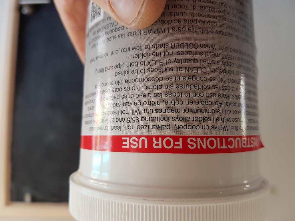

I use everflux. Works well. I wouldn't mind giving that nokorode a go though Lame. Is it the regular flux paste you use or the aquaflux? Is it self cleaning? Also were do you buy it for from? Looks like it's from the states.
my local indie stocks it, I only know it as nocorrode, cleans most copper fine, if its really dirty I just wipe it on first and clean it off again before refluxing.

Just ordered some off of the bay. 500ml more or less for a tenner all in delivered from the US of A . Must be cheap out there.
It never runs round properly. At least in my experience. Wont even do it out of place
