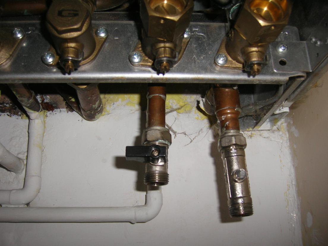

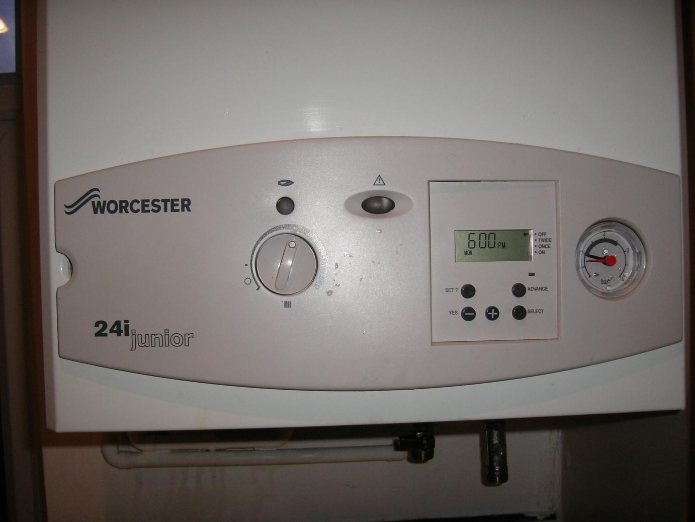

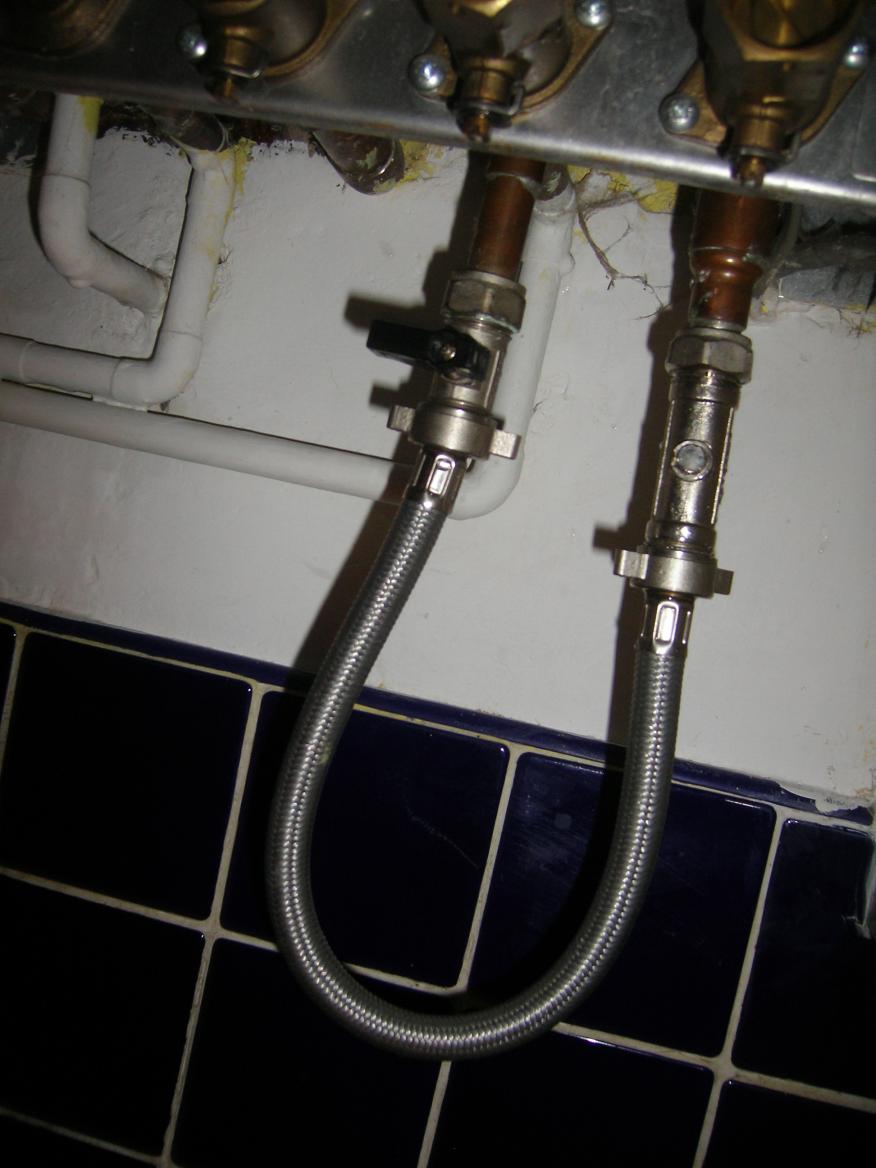

The pressure in our boiler has decreased and although there isn't any noticeable difference in the water pressure in the house, we've been told we need to increase it. Despite having done this once before a few years ago, neither myself nor my boyfriend can seem to get it to work. Instead, water just seems to be coming out of the valve on the right hand side. Please see pictures below. If anybody has any suggestions as to how to solve this, I'd be very grateful!
Many thanks, Emma

valve on the right is a non return valve (will only let water through one way), if water is comming out it it is faulty. If water only comes out of it after you connect the hose and open lever then someone has probably fitted it upside down
if you have done that, do you mean its coming out of the little nut on the valve on the right ?
Hello, yes thats exactly what I mean. When we connect the flexi hose and twist the black tap on the left you initially hear water coming through into the hose - but then it stops once it has filled the flexi hose and doesnt go into the boiler - so no change in pressure. Then if I twist the nut on the pipe on the right water first drips out of where I have loosened it and if it is undone more then more water escapes. All without any water actually getting into the boiler. Many thanks

swap the flex round the other way as have a non return valve in them as someone as said.so it can only flow one way
the non-return valve is connected to the heating circuit not the hose ! and if the non-return valve was fitted upside down you wouldnt be able to pressurise the system, either faulty NRV or incoming mains low.

dont undo little nut, if valve is wrong way round like southcoast and gquigley said it should have an arrow on it, it should in your case point upwards towards boiler, and like gq said, have you got low cold mains pressure and may not be able to increase pressure
have you been able to pressurise it above 1 bar previously before ? if so then all i can think of is a faulty non-return valve
there's no chance in hell the valve is upside down, if it was you wouldnt be able to fill the system at all, and if you did and disconnect the hose it would flood the house and judging by your pictures you've had the hose disconnected.
Hello, the valve on the left has an arrow pointing upwards towards the boiler so that looks like it is the right way round. Many thanks
Hello, yes in the past we have been able to get it above 1 bar. Sounds like it must be a faulty non-return valve. I presume that is a job for a plumber? Would the whole central heating system need to be drained? Many thanks
when the heating is on does the pressure gauge go up, about 1/2 a bar?
if it doesn't move it could be the pressure dial that's the problem
lol meant the one on the right the nrv but if you have been able to do it before then as gq sez its probs faulty, good installer should be able to do it without total drain down,

Hello, yes when the heating is on the pressure increases so I think the dial is working OK. Many thanks
