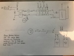

PUMP SIZING.
2 boilers max 50kw
1 250l unvented
23-25 rads totalling around 40kw
Low loss header
Distribution header
This is what we are going with. We are hoping to try to zone off what we can onto separate rf stats linked to zone valves. But as all piping is concealed and under floors this may prove difficult.
I can’t calculate index circuit so what advice can be offered re pump sizing? It’s a 2 storey property with 2 rads in loft also. Pump to be sited ground floor. I’m guessing a single 15/60 won’t be upto it but didn’t want to over spec a pump.
thanks in advance for any advice

If your going one main one 25-80 will do it fine
Separates 15-60 will be fine
Header needs to be 42mm tho
just to clarify,
if Im just going to tag onto existing flow and return and see what happens (1 big zone) then 25-80.
if I'm able to zone off into 3-5 zones then 15-60?
do you mean distribution header or low loss header? I got my calc at 35mm? wondering now if I've made a mistake on the header??
Correct pump just after the llh/plate on commons/ header 25-80
Each leg/zone 15-60
And 35mm is pushing it for 5 zones when there all pulling prob just scrap it but I wouldn’t

You’re right. I can easily upsize to 42mm. So will do this.
If I only had 3 zones do you think 35mm ok? It’s so difficult to gauge without seeing any pipes existing.
I guessing one 25/80 is the way to go instead of 4-5 15/60’s. Far cheaper option ?
Thanks for your advice it’s very useful

Heat loss, boiler sizing, pipe sizing to distribution header all calculated. Th only thing I’ve not is the pump due to all concealed piping (existing). I’m zoning what I can but just needed advice on pump

Thanks for your info. Like I said there’s 21 plus rads inc unvented cylinder and some very long runs of pipes in 22. Some of the 22 legs running 16 plus metres flow with 4 rads each about 1.5 - 2kw rads.
I’m fitting the IMI trvs with inbuilt flow setting. So I size the rad off their app and set the trv internal setting to a number which corresponds to the required flow rate of that rad. I’m hoping this helps settle things. I’ve tried as much as possible to size everything.
like the drawing shows I’ve got 2 boilers 18-25kw
Both 22mm cascading into 28mm. Running about 6m to a LLH (sized correctly) then to the pump(not known which yet) then to 42mm header with 3 zones.
so is the consensus to use separate 15/60 on the zones or one main pump after LLH?
the below image shows day one. Note the distribution header is positioned on this photo is to be sited to the right of where it is now. The pump will fit in this gap.
If it were me, I would do two designs one for the best and one for worst cases of the pipework I cannot easily access. Oversize the header and then look at other areas where oversizing would give you more flexibility.
I don’t like noise from a heating system so I am always looking to keep the velocity At the low end of the specification.
With respect to pump, if you follow the above, at least the required range will be evident.
Sometimes, if you are really unsure, the multi pump option can give you more flexibility to fine tune an existing system that has not been properly designed.
As always, you can throw together a ten rad system and get away with it - but that is far less likely on a 20+ rad system.
Hope this helps

So looking at my recent reply would you go separate smaller pumps as apposed to one big? I know it’s difficult to guide me without seeing it but I’m thinking both will work.
Downside of the large pump I’m thinking if there’s only one small zone open, it could be noisy unless the pump can modulate right down.
Separates would require 3-4 pumps and valves which obviously more expensive.
The current house is running off one circuit , one 15/60 and doesn’t work very well (obviously)
I think I would consider two possible routes. A single pump with Evohome control on all of the radiators - ie. each room is treated as a separate zone.
Alternatively, configure for a multi pump installation and fine tune the system thereafter.
