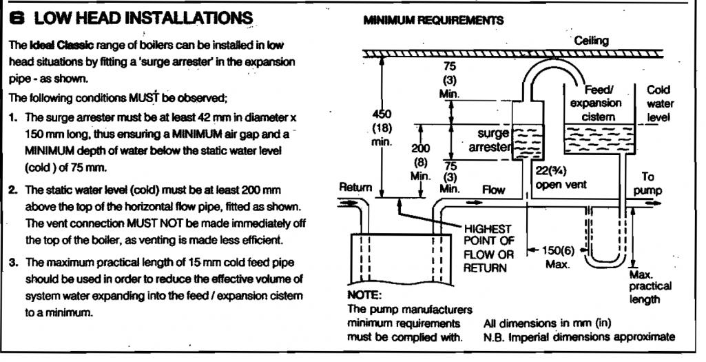

Regards your boiler .... it cannot be fitted to a sealed system or combined feed and vent system. However in the instructions you can fit a 'surge arrestor'. Seen it done a few times Hopefully this image will help you understand what I'm talking about if it uploads okay 40NF Low head.jpg

Regards your boiler .... it cannot be fitted to a sealed system or combined feed and vent system. However in the instructions you can fit a 'surge arrestor'. Seen it done a few times Hopefully this image will help you understand what I'm talking about if it uploads okay View attachment 4203

Regarding the "surge arrestor", is this a "bought" or a "made" item ? Can you confirm that this will remedy the "pumping over" problem despite the "root cause"(whatever that might be) not being identified and remedied ?
I can't access your pics ... however without knowing where the two main pipes in question are connected the surge arestor will not fix pumping over, especialy if it's a constant flow of water! The pump is raising the 'head' of water to a level above the height of your vent pipe if the flow is constant. A surge arestor isn't there to prohibit that.
