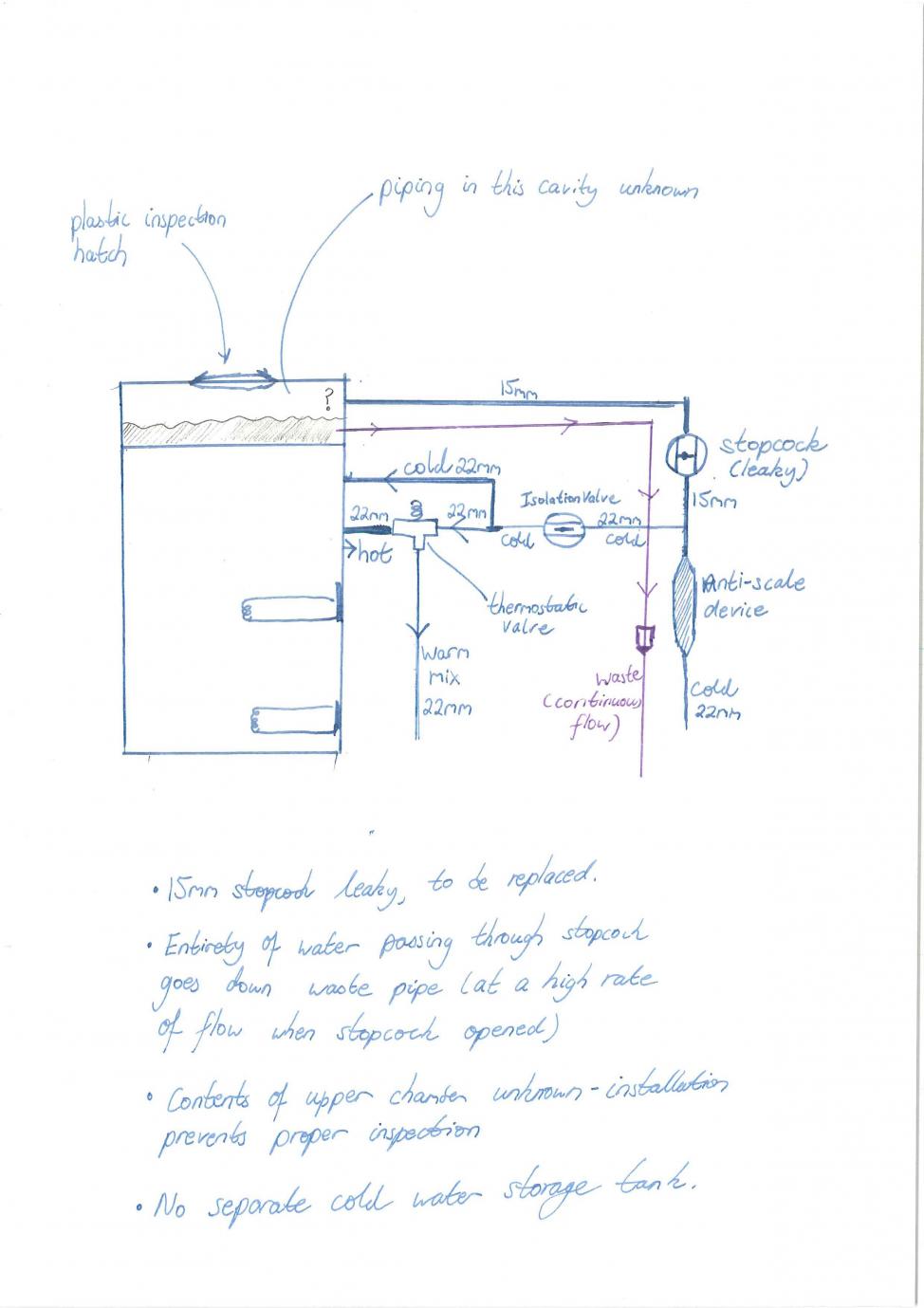

In my third floor London flat, I have a water heater that is about 20 years old. The tank does not have a separate cold water storage tank.
The plumbing is complex (illustrated in the diagram below) and is displaying some anomalies.
The tank is fed from the cold mains supply via a 22mm pipe, that joins the upper third of the tank and connects also with a thermostatic regulator. In addition to this, however, there is a 15mm pipe that joines the cold water mains, and leads, via a stopcock, to the very top of the tank. At the top of the tank is a void, accessible by a plastic inspection cover. Unfortunately, due to the way the tank is installed, it isn't possible to see what is inside. However, putting my hand inside shows there is a considerable amount of water.
Water is constantly flowing out from the plastic waste pipe, which also joins the very top of the tank, at a rate of about half a litre per minute. If I open the stopcock (which is currently leaking), the void in the upper portion of the tank fills up, and a very substantial amount of water flows out from the waste pipe.
No pressure relief valve is visible. I'd be very grateful if any of you could advise what is going on with this tank.
