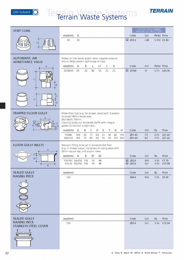

AWheating - I can't find a chrome trap with aav. Does it exist? Maybe I could use a deep trap (ie. 75mm water seal) that is described as re-sealing instead?

like simon has said you could vent it with a normal cowl, you get them in 50mm but im not sure if you can get em smaller. (see top of pic)
