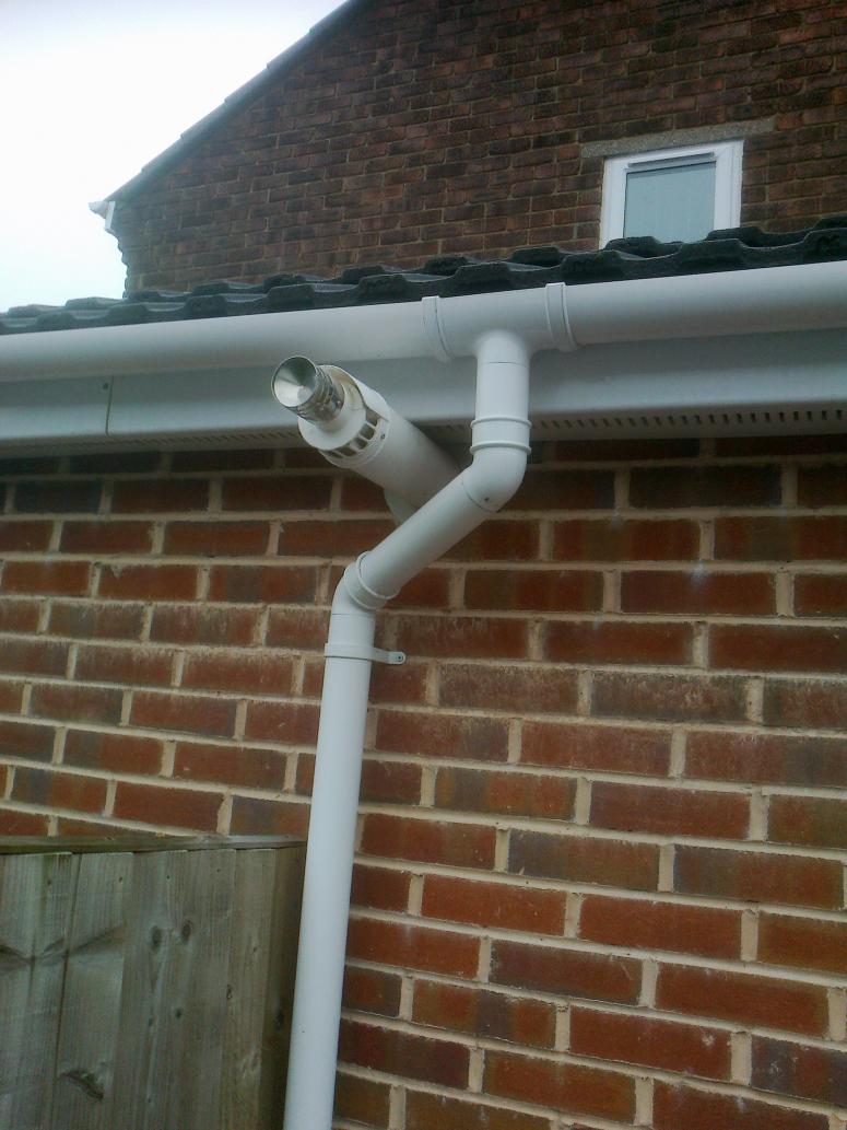

went to this today found the following
flue falling wrong way and not 300mm from vented eaves
gas undersized
in hw mode heat passing to htg so plate or diverter shot
pipework done in pushfit to boiler
blow off in plastic fittings
customer bought house 4 month ago and all the solicitor and estate agents were worried about were the fensa certs for the windows come on a window cant kill surely a gas cert and electric cert is mor inportant

TBH, I think what most of you have said is correct, Ravenheats are fitted by idiots who haven't got a clue, or by people who don't care. I fix them on a regular basis and have found most of the faults on them are due to them being made poorly and not particularly well designed. Having said that, all the ones I repair are now circa 8 years old. Some of them look brand new and some look like they've been dragged through the scrap yard on a length of rope behind a Hi-Lux.
Going back to the original post, depending on what model it is, the CSI 85T and AT have a 15mm connection to the gas valve, but if there is a long run of 15mm, 22mm should have been used. The CSI os effectively a SE boiler with a secondary heat exchanger which creates condensation and reduces the flue gas temp. So there's no sucking on the gas, it comes out as if it were a normal SE boiler. A thing to watch on them is if the min and max burner pressures are correct, you will get very high CO if it hasn't been set up correctly on the modureg. Plastic is usually used for a prv pipe if there is a chance of it being stolen.
If it's got the large diaphragm style gianoni diverter valve, then that'll be the part to replace for the DHW issue.
