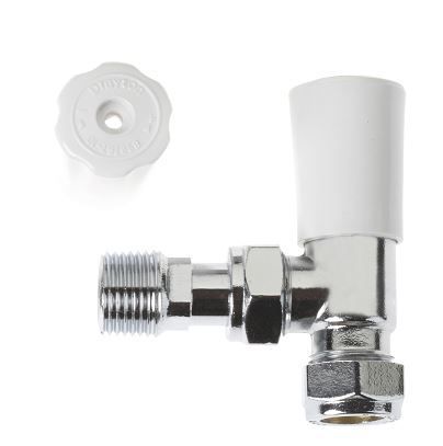

Hi, I have a standard radiator (1/2" female bsp) on which I'm installing a new lockshield/TRV kit. The lockshield is similar to this:
What happens if I remove the nut and everything on its left in the pic, and screw the valve directly into the radiator (with PTFE)?
This would simplify my space arrangements a lot, but before actually trying I thought to ask if this makes sense at all.
TA!
Will come with wheel head cap and lock shield cap.
Great, thanks! Just realised (sorry!) that in your link there is exactly this question in the Q&As section. And an answer to another question states
Our supplier has advised as follows: 'Yes, this is bi-directional flow. The consumer can use it as manual radiator valve with wheelhead, or use it as lockshield with cap.'
Which sounds encouraging, so thanks!
