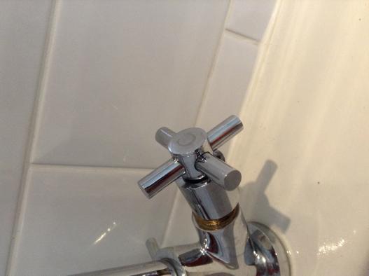

I'm attempting to remove the cap on the end of this tap. I've tried:
1. Looking for grub screws/key holes
2. Levering it off with a tiny screwdriver blade (0.5mm)
3. Using a strap wrench (although it was probably too big for the job)
4. WD-40
5. A cloth and a set of pliers
I don't know for definite who made the tap unit, but I think it might have been 'swift' - just from browsing through a screw fix catalogue that we may or may not have bought from. It's only about 15 months old.
Before I try #6 (hammer), can anyone tell me how it's secured (screw thread or cap?) and the best way of getting it off please?
Thanks very much.

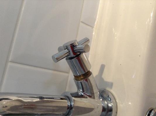

try undoing one of the tap handles.......................... never seen one of these but hey ho
either the top unscrews which looks most likley as im sure i can see the join in pics or one of the prongs unscres and theres a grub screw under neath
The handle may also be fixed from underneath the handle.
You may need a tool to undo the locking nut.
They could be 'tamper proof handles'
As Shaun and Steve said, the top caps unscrew. You can clearly see the join. There'll be a Phillips screw under the cap..
You mean the tool with the bent 90 degree lugs. All the cleaning agents would get in and seize the lock nut, you'd end up bending the lugs trying to get it undone.
Great stuff - thanks to all that have commented. snowhead - thanks for the photo, that helps.
So what's the best method to get the little cap off? I've tried brute hand strength (yes, lefty loosy...) and a strap wrench that is too big for the job (annoyingly). Shall I buy a smaller strap wrench or is there another tool for the job?
While I'm at it, any suggestions for a lube that will penetrate and loosen up the screw thread?
Thanks again all.
a pair of smooth grips or a strap wrench if you can get it on warning with the grips tho if your not careful it might mark the chrome
and none shouldnt be that tight
