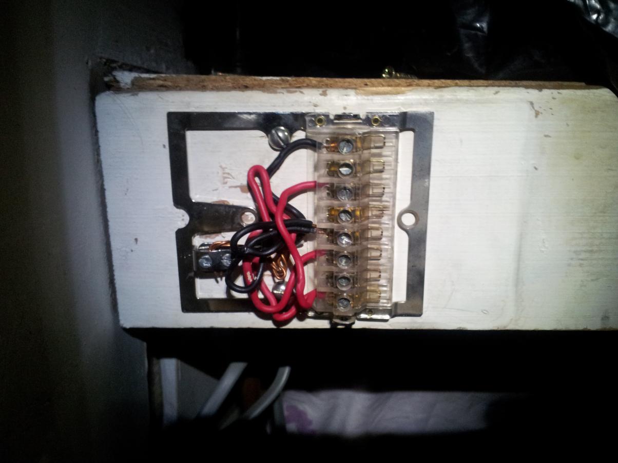

I've inherited an old Sangamo M5 ticking bomb clock!!! and have a Drayton LP722 to replace it with. It should be a pretty straight forward swap but i'm just not too sure what the old Sangamo wiring is and what goes where.
old Sangamo M5 unit
1 - 2 red wires (1 bridged with 6)
2 - blank
3 - 1 red wire
4 - 2 black wires
5 - blank
6 - 1 red wire (bridged with 1)
7 - blank
8 - 1 black wire
there is also 1 red wire that's not connected to anything. It an old gravity system but it all works. I'd just like the ticking to stop before it drives me mad!!!

Assuming that you understand the components of your system and how they interact with each other, you'll need to trace which cable does what with a multimeter. Do this with extreme care as all those wires could be live 240v.
If you don't understand the components of your system you might be better off getting a heating engineer / plumber to take a look.
E - Earth = E
Then it should be as follows,reading right to left
L - Live = 3
N- Neutral = 4 (the two black wires )
3 - HW On = 1
4 - CH On = 8
disregard existing loop
switch/pins on back of programmer to gravity hot water,if you leave on fully pumped,if you put heating on by its self all that will happen is pump will come on,you can only have hot water or hot water and heating on your system
This is a guild only,tests should be carried out to varify wiring and would be good to see some earth covering on the earth cables
