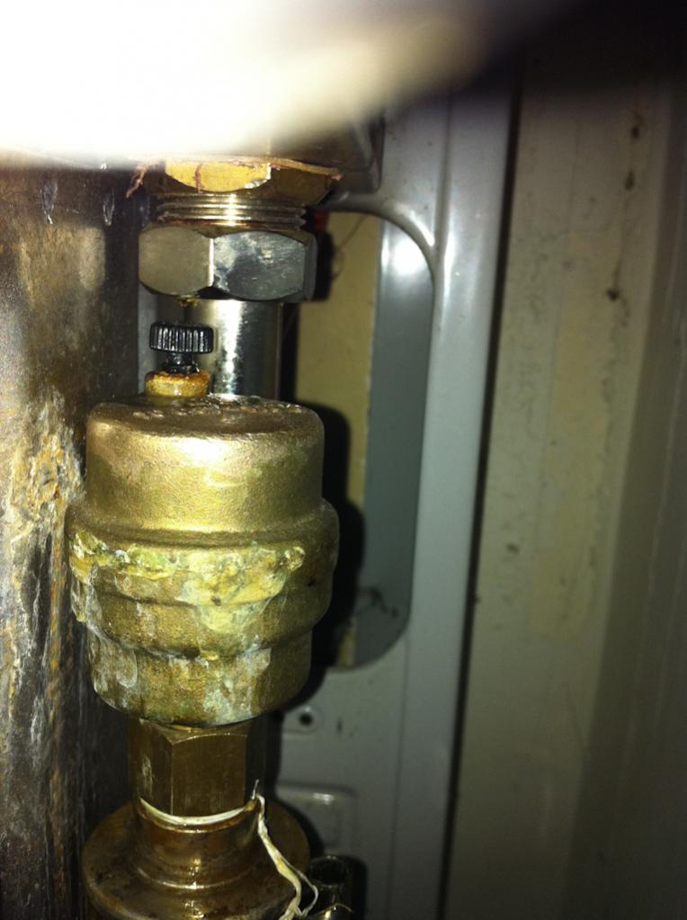

Thanks again for the help so far! I started refilling the system after following the above suggestions, and the boiler - a Vokera 20-80 R.S. Turbo (not flowmatic) - started to drip. I stopped filling and took a quick look and it seems it's coming from the auto air release valve, approx one drip every two seconds and gradually slowing. The CH pressure gauge is still at zero.
The black cap/knob on top of the air release valve doesn't seem to want to turn in either direction and there is some limescale around it's base and part of the body of the valve housing, perhaps suggesting it may have leaked in the past (maybe fixed in an annual service? We did have a drip for a while a few years back which i had thought was condensation.) Please see pic below. The top of the valve housing is a little wet, but most of the water seems to be coming from what feels like an opening in the rear side of the valve housing. The opening feels like it's part of the design, as far as my fingertip can tell.
The first step in the instructions for initial filling of the boiler says to open the black cap one turn and leave permanently open, so I assume it's open but scaled up.
Is it normal for water to come from this valve while refilling? I did partially drain the system a few weeks ago, when I thought I would have time to replace the rad etc but in the end didn't, but I didn't get any dripping or leaking that I was aware of when I refilled that time and the hot water and CH have run fine in the meantime.

Did I mess up? Is this normal or is the valve gone/going? Or..? Hoping you'll be kind enough to help me again -
David.
