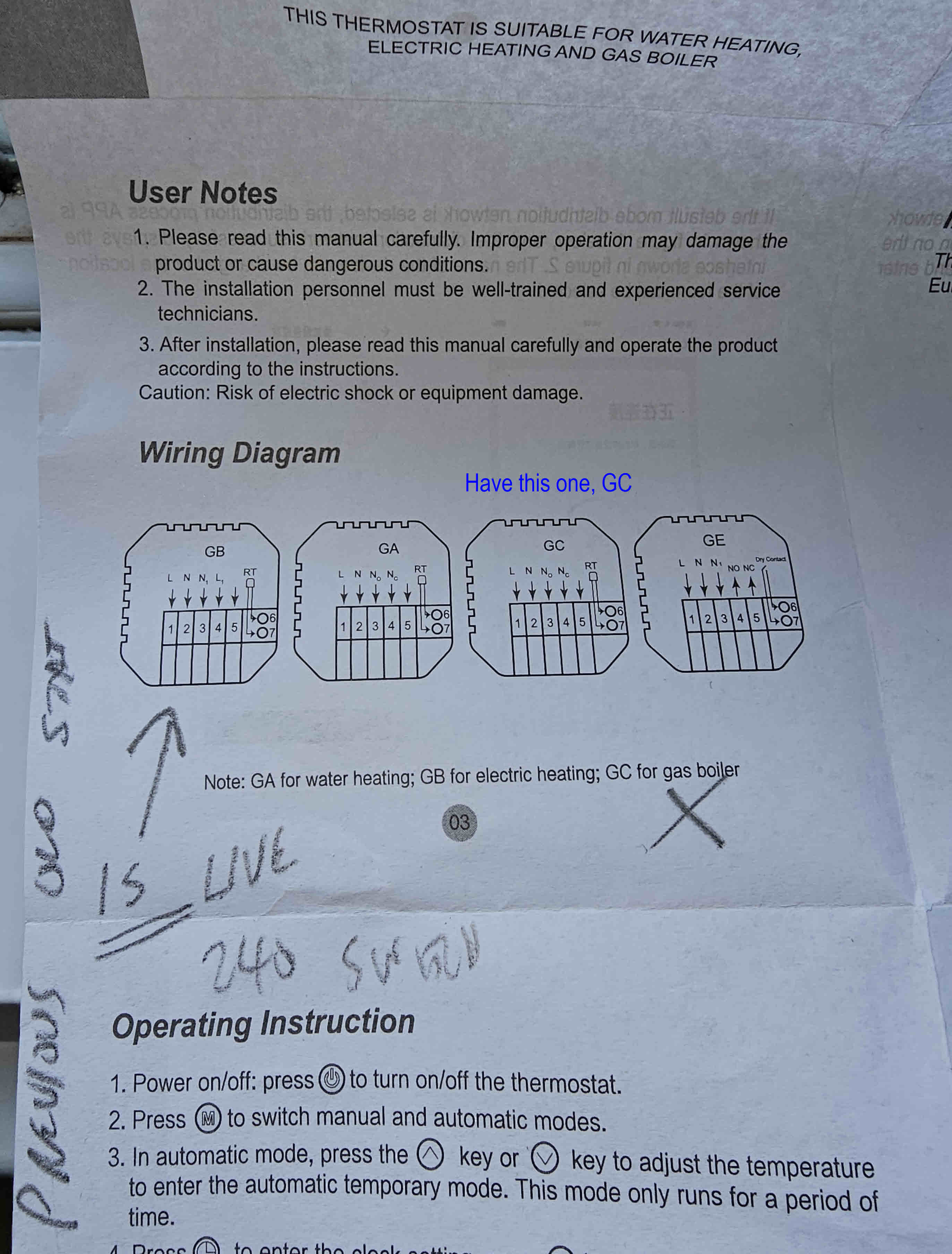

Recently had a new Worcester Ri 18kW installed.
Wan to change the room thermostat, just one zone.
Left existing honewell dial but would like to change for a digital & ideally WiFi
Ordered one from Amazon, says for Boiler but on reading the instructions it uses a dry contact, no 240v switching.

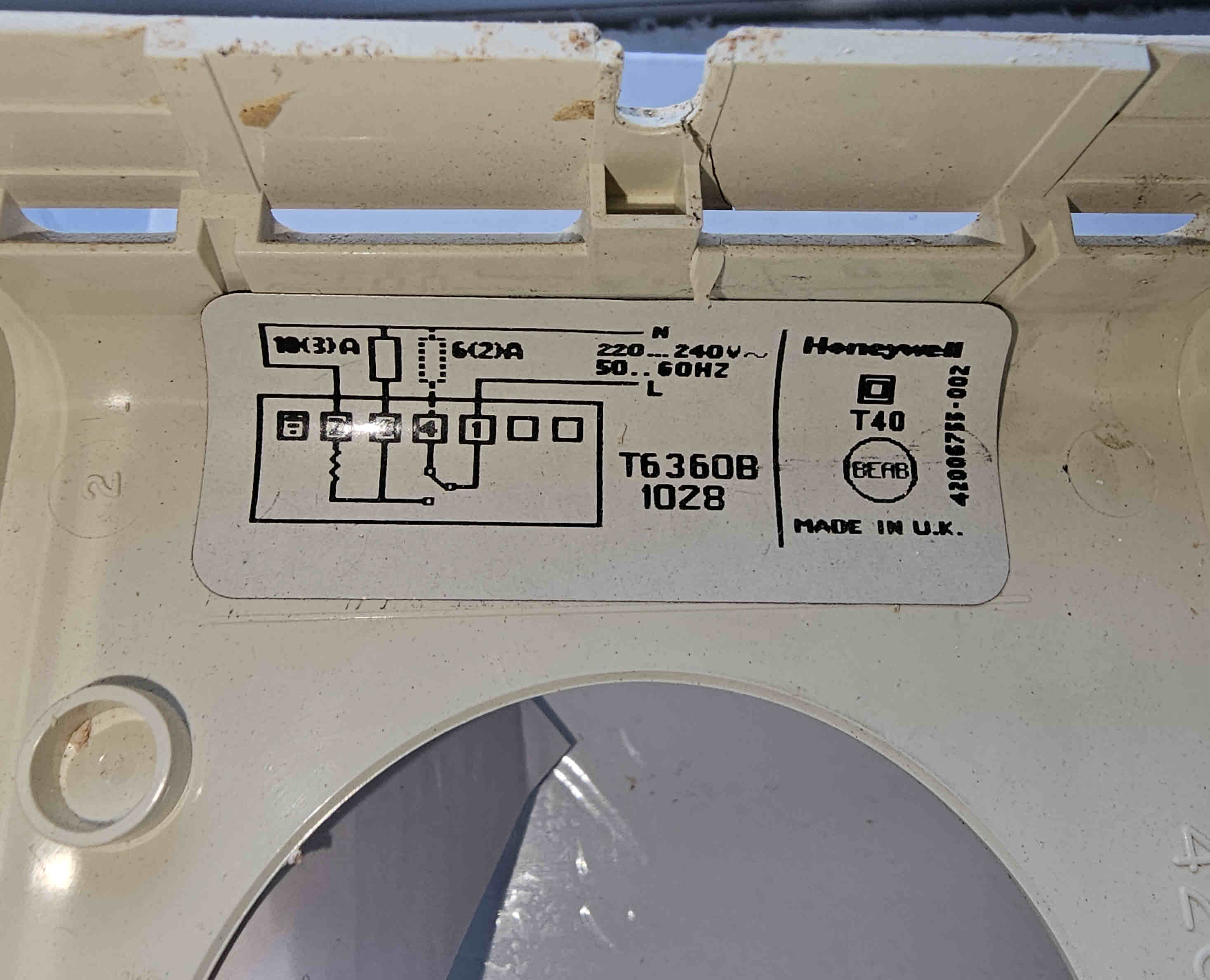

Fairly sure I am understanding the old wiring. As original connections
(1) Live source
(2) N
(3) Switched L (240v) when I turn the stat temp up, zero volts when turned down.
Earth far left, (4) Not connected.
Appreciate the new one below is wrong, did test & never does it put 240v onto any of the other terminal.
Would not have thought too much of this but reading online says most use dry contact & I think even specifically the Ri 18kW.
a) Is this 240v switching fairly normal & just wired differently at the terminal box at the boiler end.
b) If I got GB, should that work switching live. I only have one N into the control, can I share that, may not sue that anyway back at the boiler but perhaps the thermostat won't be happy unless it has a N on (3) also.
I read elsewhere that live is passed through the thermostat & the switch causes the "break" indicating teh call for heat. Describled as nto the same as 240v switching but don't see the difference.

Thanks for you reply,
Not quite sure how GE would work.
As I say my old dial switches 240v which assume I need to replicate
Just checked again testing from earth, the old Honeywell ..
(1) Live source, 240v
(2) N
(3) 240v when I turn the stat temp up, zero volts when turned down, in my case grey wire.
N0 & N1 surely are just Neutral, I need 240v to go down the signal wire.
What is the make / model of your new thermostat?
(2) N
Your switching live
Gc switches neutral
For ge
Perm live to live 1
Neutral to neutral 2
Switch to no4
Many thanks
So the NO terminal will feed the 240v (from L terminal 1) to the boiler when stats turned up?

I was thinking a Normally Open terminal was just closing a circuit without voltage so as to signal the bolier.
The old Honeywell T40 really just shows & describes as switch live, nothing about NO or NC.
Many thanks
guessing to the 2 port valve (there are two separate 2 port valves, HW & CH)
In theory yes
And yes but there no common terminal so there has to be a link inside you can test put live and neutral to the stat
Turn stat on eg you want heating / call you should get 240v on one of the terminals (with a multimeter) and turn the stat off eg you don’t want heating / call this should remove it
