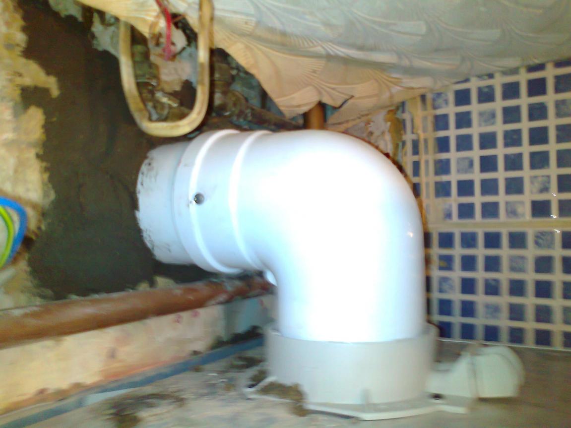

one i done a while back not going anywhere with sand and cement and finally plaster to keep it there,but with a screw its not going anywhere,its not in the mi,s either but i feel you cant be to safe do something right and it wont go wrong
