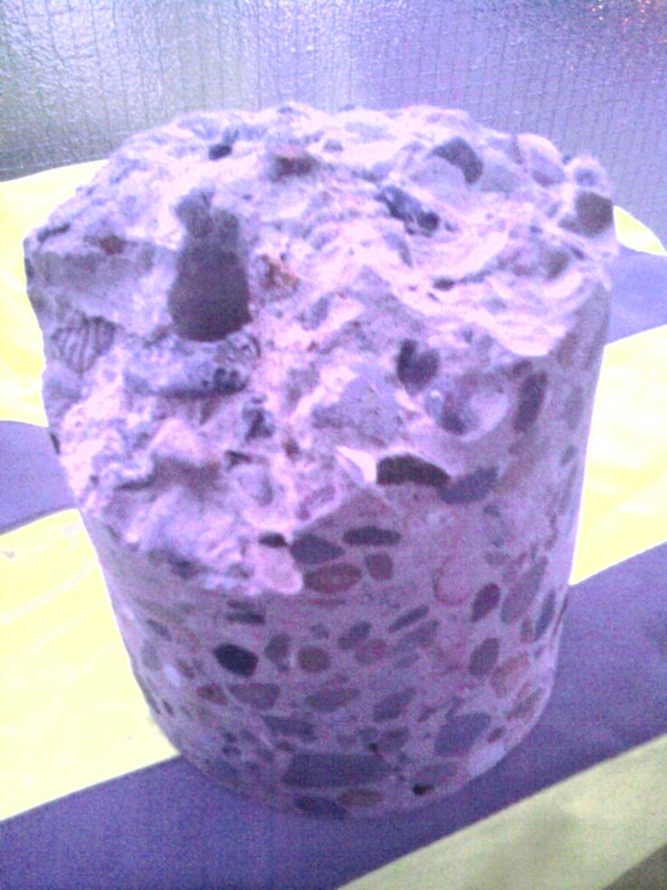

Here's what I tested my new one out on, the hole is from a 16mm bit and the damage is from trying out the chiselling function:
