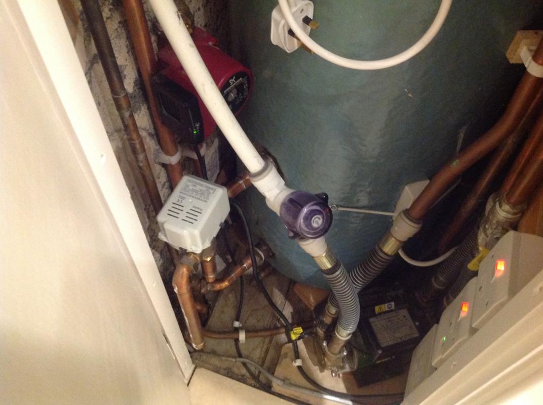

Hiya. This has been going on for years, just been putting up with it. It was all installed about 10 years ago just before we bought the house. Recently had a new boiler and the valve that allows seperate control of hot water and heating plus hot water cylinder stat which we never had before. The hot water is now a more stable temp and the run from the hot tank to the shower valve is about 1 metre max. Just holding the white plastic cold supply pipe in cold weather shows the temp difference.
View attachment 28963View attachment 28962
