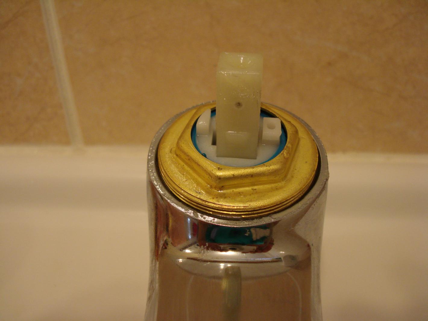

Thanks Tom I have successfully removed the top of the tap - it was a small screw which was deeply inset - what happens next! I presume I have to remove something else called the cartridge - could you talk me thru that? I will try and attach a picture. Thanks. DSC00659.jpg
From the top to the chrome is the cartridge. Turn the water off (might be an isolation valve under the basin). Then out with a spanner and undo it (brass nut shaped part), then find a replacement and fit.
Sounds easy. First trouble might be removing it without damage. Might be safer to remove from the basin first but hopefully you won't need to do this as tap is not too old. It'll take an effort though as they're fixed quite well at the manufacturer. Finding a replacement won't be easy. Take the part to a plumbing merchant and then another merchant and then another ...!
When you replace make sure the pipe connection to the tap is water tight as well.
Good luck - and if you manage it you'll make the local plumbers happy as finding replacements can be a right menace!!
