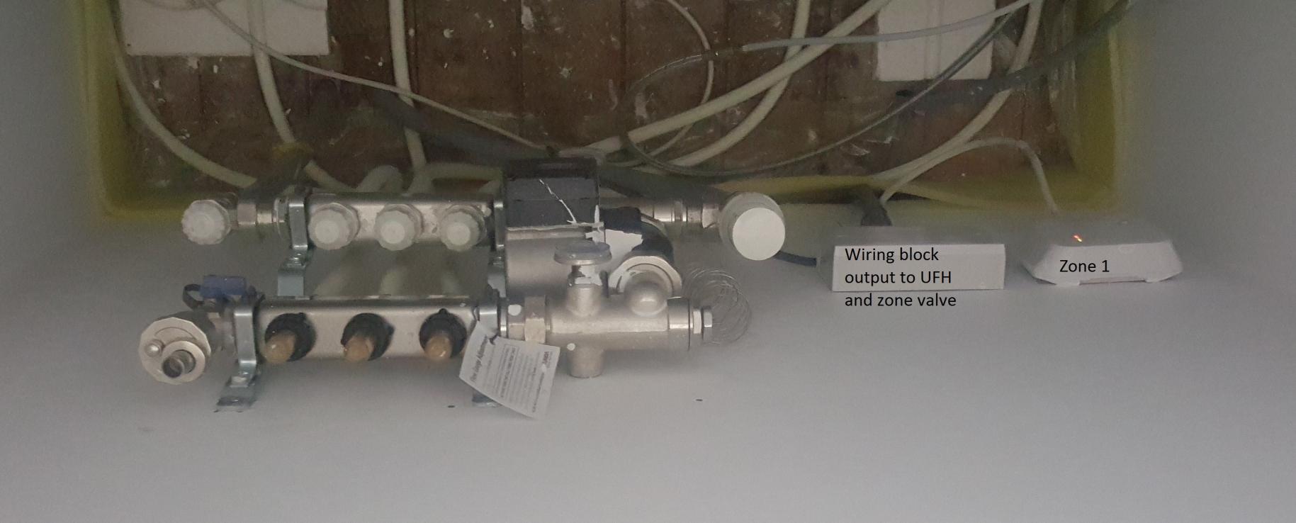

The current heating system is a system bolier (Ariston) and a separate water tank that is heated by said boiler this has a honeywell control panel to fire up the boiler to heat up the water on a schedule.
I have a four zone Central heating system controlled by individual Salus RT500RF thermostats.
One of the Zones does a wet UFH system for the kitchen and dining rooms as well as the two hallway radiators.
The system is about two years old and works fine as designed and programmed.

See attached pictures for my setup.
For the Heatmiser i believe I would need
4 Neo Air thermostats (3 for the each individual zones and 1 to do one zone and the Hot water.
1 Neo Hub for internet connection
(optional) Neoplug to boost signal if weak
And this is the bit i'm confused about:
I know i need 1 Heatmiser UH8-RF in the utility to replace my three RF receivers as well as my Hot water timer. and control the zone valves
Do i also need one in my kitchen to control the UFH as well as the radiator zone valve in the front of the house or can I get away with a Heatmiser RF switch?
