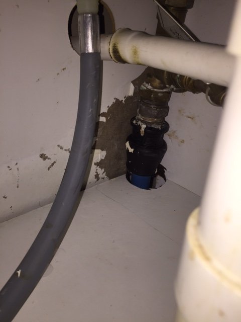

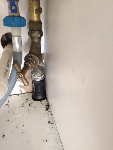

Apologies in advanced if my question is really what this Forum is for. I need some advice regarding a recent issue I had with the fitting from the mains blue pipe to the stopcock. It started with the plastic fitting was dripping. The Plumber used some tape on the thread of the stopcock and screwed back in; when he turned the mains on it split and flooded the kitchen. The BEFORE.JPG shows the fitting cracked. He then came back and replaced the fitting as in the AFTER.JPG.
My confidence is a bit low with the work that has been done ad I'm terrified that when I put stopcock on I will burst the fitting; is this a risk or am I being stupid?
Many thanks for any advice.
Chris

Hi, he shut the water off at the mains in the street and replaced the fitting and switch water on at mains. However, he didn't turn off the stopcock under sink and that is the one that I'm worried about switching off; by that I mean, by turn that on will it create pressure and break the fitting. Or if there was an issue with the fitting it would be failing already with the stopcock open.

I think the answer is get the guy back and get him to demonstrate that everything is working as it should be. If he has already caused a flood then I think out of courtesy he wouldn't mind there is no reason why what he has done would leak or flood again but better to have a pro there just to be safe
The old fitting was probably already split
When he taped and refitted the stopcock it split even more.
I doubt it was the pressure when turned on that split it

The new fitting should be OK.
It has the steel ring around the female thread.
The fitting that burst had no steel ring to hold the plastic together.
The steel ring was fitted to the fitting due the problems like your
Had this sort of thing happen in the past - outdoors -
I would try and avoid using any poly fitting with a female thread.
