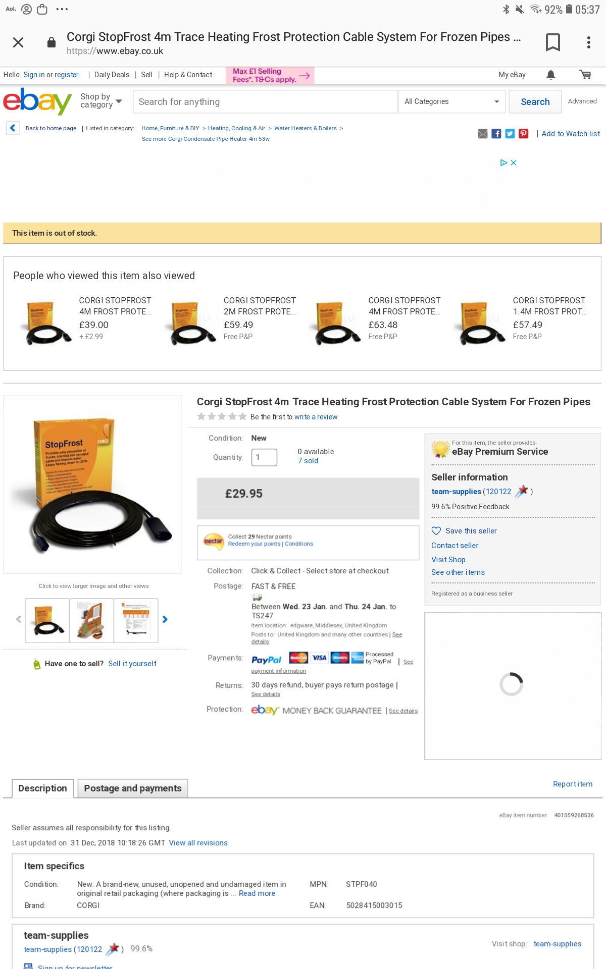

Easy way to stop freezing is fit a trace heating kit and lag up the pipework . Kop
