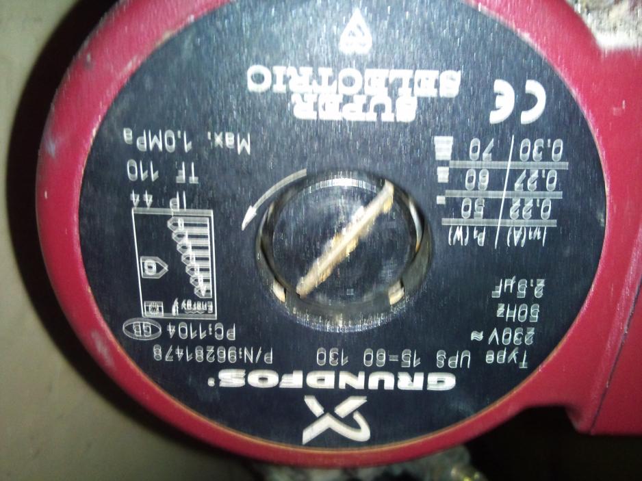

6- system used to be open vented then a new like for like boiler was installed and a system alterted to sealed, then problem started. DSC_0331.jpgDSC_0332.jpgDSC_0333.jpgDSC_0334.jpgDSC_0335.jpg

can i check the pump is on the right way round?
Right or wrong it would still circulate ... Pump has an arrow on it though telling you flow direction!
