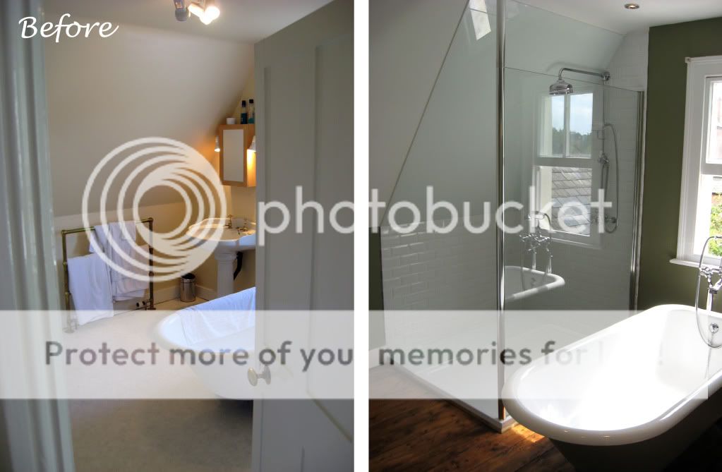

Danny, What's that stuff you've used on the floor sloping into tray? looks good, glass like isit?
Steve, it's painted glass. I use it quite a lot. It's stuck to the sloped ceiling too.
I have a guy I use from London that supplies it. You can buy in most local glass suppliers (special order) but it's very expensive. I pay around £120 a square M, depending on how much I order.
It's made for wet areas, and you won't get problems with delamination of the paint.
Finally, it looks the absalute nuts in the tight place. I first came across it when working for a interior designer. I nabbed the guys number.
If you're anywhere near London, he comes and delivers. He also fits for a charge but it's straight forward so I do it myself. Let me know if you want his number.

Respect Danny,very nice
Great job.... customers must have been very pleased🙂🙂
see they had no towels afterwards,hope you did not use them as dust sheets !!
Thanks Puddle. It always means more coming from a fellow tradesmen.
I am proud of my work. That's the main reason I do it!
In the process of stripping down my portfolio for my website, this forum is a bit too distracting though!!
Oh and the towel rail pictured is in my shed!! The client let me have it, I installed a chromed one which is out of shot.
Very nice Danny, no expense spared on the shower screen either, beautiful, nowhere near london but will hold the thought on using painted glass in designs in future, most interesting. Bet the ceiling glass took some praying putting that up lol.
