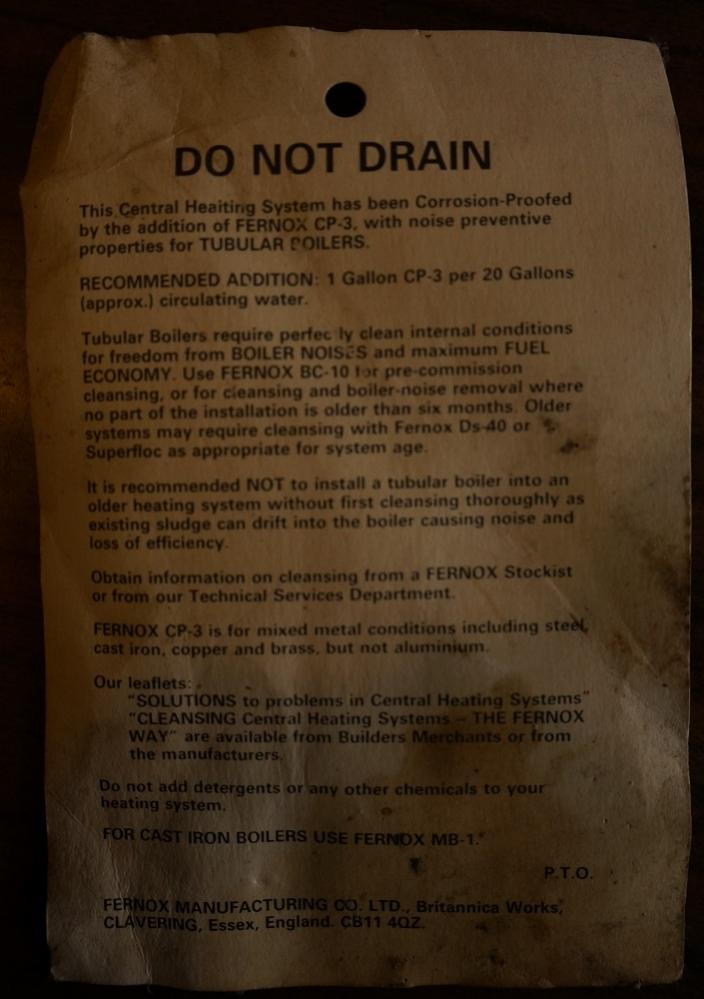

The two most common branded products, Sentinel and Fernox, offer simple test kits for their own products, they claim that they are different chemicals, so their test kits are specific to their product. Additionally not all our clients us the 'retail' brands.
As we work on many different systems (sometimes with large volumes e.g 1500 litre buffer tanks) we are looking for a generic testing kit that can tell us the % concentration of inhibitor. - Simply saying 'not enough' isn't adequate.

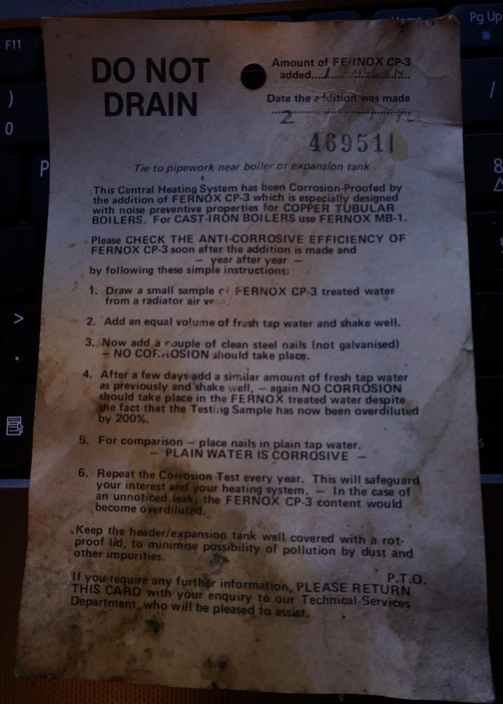

What's the nail in the jar test?
What it says on the tin!
Get a clean bright nail (not galved or coated) take a sample of water from the system in a jar, put the nail in the jar, put the lid on and leave it for 2 days, see if it goes rusty.
Some people use wire wool as it has a larger surface areas.
To be really true there should be no air in the jar - it should be completely full, else the air can get absorbed and the nail should be fully submerged.

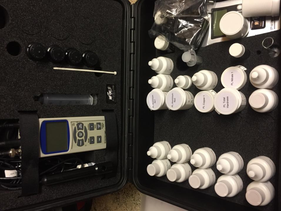

I use this Primelab.
