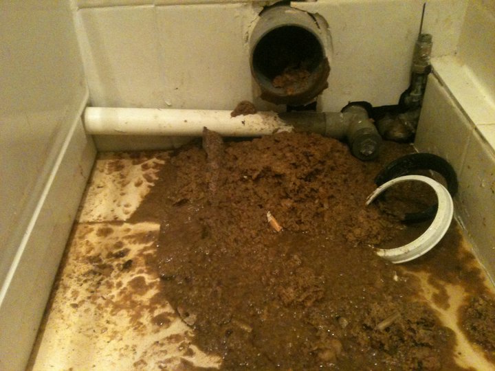

the tenant wanted the toilet removed, we advised her that it might not be a good idea, she was adamant, so we obliged. As they say in the Sun, we made our excuses and left....

At this property there were 5 storeys, she was on the 3rd floor, sharing a communial stack, the blockage happened to be between the 2nd and 3rd floors. So she was lucky to get to see what the 4th and 5th floor tenants had for supper. Not only that, there is a hole at the back which goes straight on top of the ceiling of the flat below, where much of this muck went too...

She wanted it removed, because the bathroom smelled, it was an internal bathroom so just a non working extractor. No access to any of the soil pipe as it was all hidden internally. After plungeing furiously for 20 minutes or so, it was obvious that everything in the pan was rising. I suggested to the letting agent that a drainage company be called in, but because it was her only toilet, it had to be dealt with there and then. So after warning all of the possibilities, this was the result. She ended up being put in a top notch hotel, Specialist cleaners were brought in, 2 different drainage companies were call in. And I earned a great deal of money, mostly spent napping in my van outside waiting for the others...
