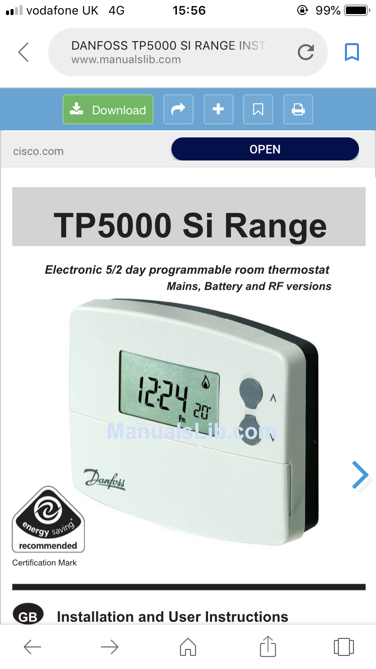

Replace the old receiver with the new receiver as that should have had mains voltage.

The old wiring for the device that the thermostat talks to, to bring the boiler on and off?
