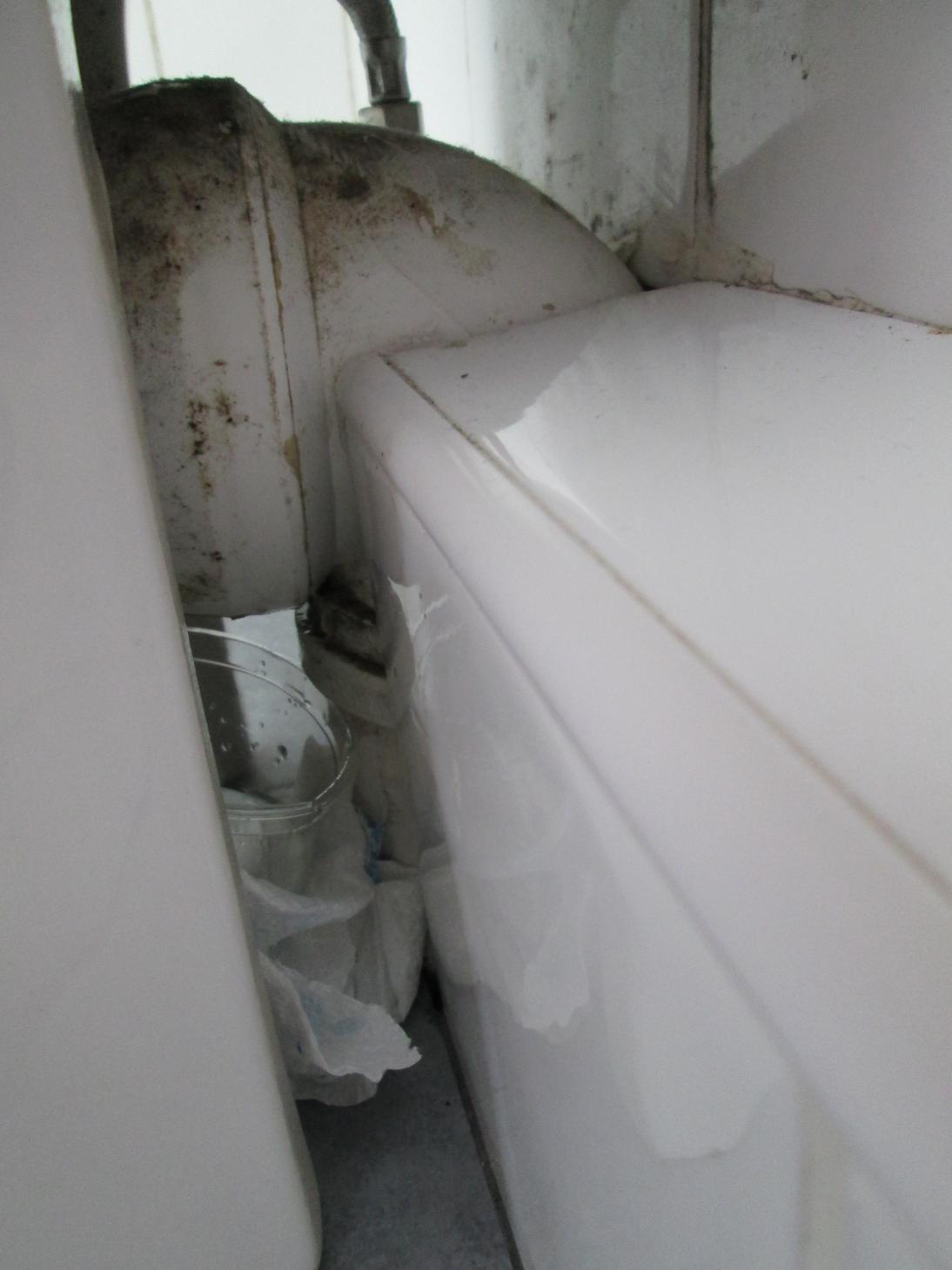

Hi All,
I would really appreciate some advice. The toilet at my Mother's place is leaking, and I think the source is the pan connector seal but its very hard to see (PICS ATTACHED) - drips are slow but when flushed water appears to flow from the seal and then drip down the U-bend.
I want to get a better look before I call someone out. Its a Vista Retro close coupled open back toilet (FIRST POST SO CANT EMBED LINKS: bathshop321. com/toilets/close-coupled-toilets/vitra-retro-close-coupled-toilet) with a dual push button. I went to remove the cistern lid and tried unscrewing the outer ring of the button but met some resistance and I don't want to force it until I'm sure. Does anyone know if unscrewing is the right way for this make/model?
Secondly, if I am looking at a broken seal on the pan connector, does anyone know roughly what £s I should expect for parts/labour on a (I'm guessing smallish) job like this?
Thanks for any info you can give me.
Ed

Appreciate the reply. I dont think its coming from the washers above - i've done a couple of checks and its either the pan connector (of which I'm pretty confident) or the siphon itself. I want to check over the whole toilet to be 100% though.

Looking at the pictures, and all the staining on top of the pan connector I would put money on the leak being from the doughnut washer. The cistern needs taking off so I would recommend you get a competent plumber in.

If you have isolated, flushed and drained the cistern clear of water then the best most definitive way to find out whether it's the multiwick (pan connector) or not is to throw a few buckets of water down the pan and check each time. Without getting water all over the place-down the pan only!
