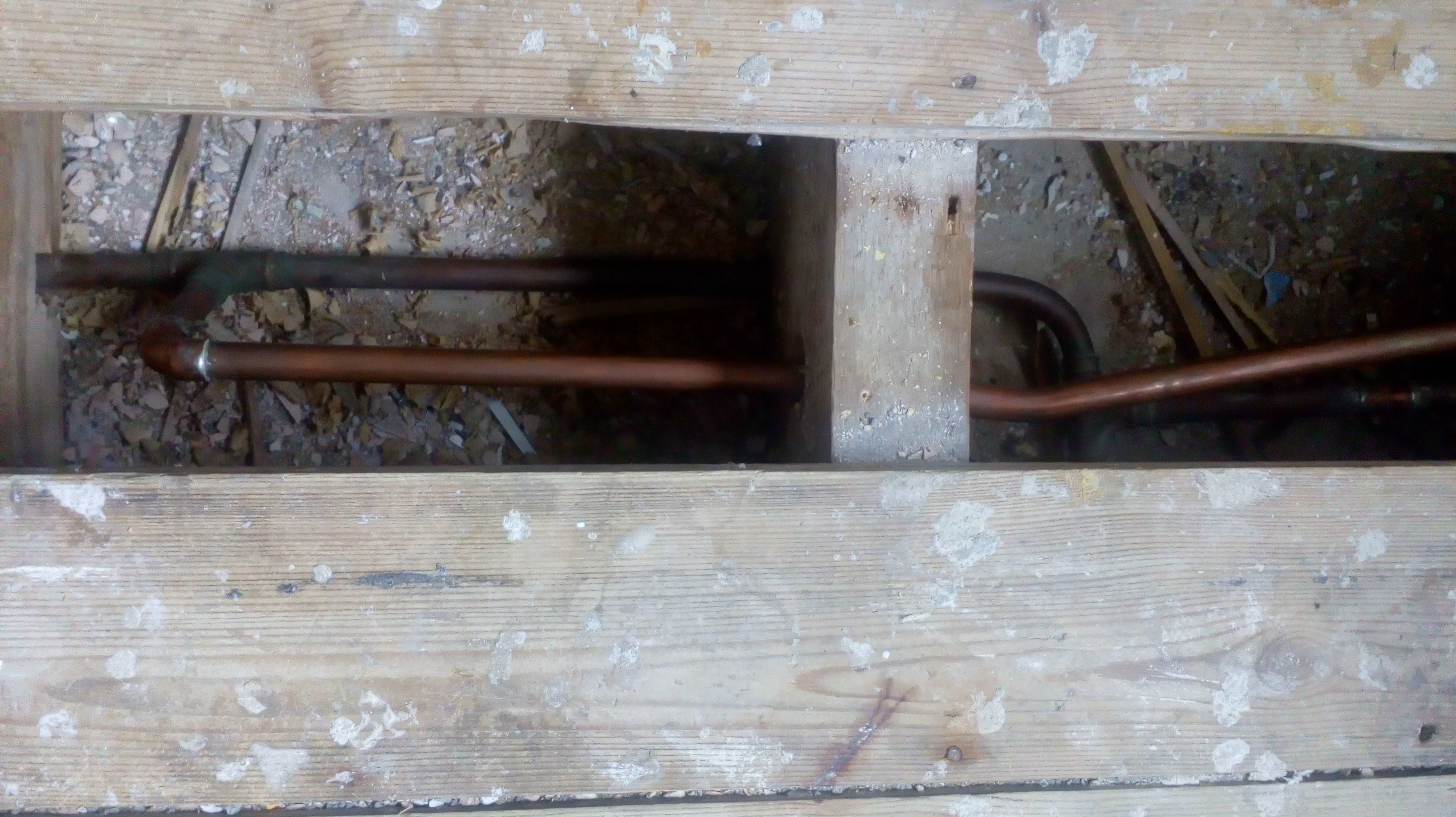

I have a towel radiator that is causing me a bit of a headache. I worked fine until the heating came back on after the summer. The radiator never heated up after that. I've taken the floor boards up and found that the radiator has 2 feeds from the heating supply. Can't work out why its not working. I have photos but can't workout how to upload them on here. Any suggestions welcome or if anyone willing to fix it in Huntingdon area please let me know.

Thanks for the reply. I have uploaded a photo. I have tried turning all other rads off in the house but still doesn't heat up. The system is one with a header tank in loft, boiler and pump in the airing cupboard. It looks like the radiator has been put on a supply loop at some point in the past looking at the newer section of pipe. Water flows through both rad valves no problems but my theory is that both feeds to the rad are fighting each other. It still doesn't explain why it used to work and why it doesn't now.
Ok - you say water flows through both valves, tell us more? (as the water is 70C why does this not heat it?). Can you bleed the rad?
Yes I have bleed the rad. I have removed it and attached attached a pipe to each valve and opened them one at a time. Water flows from both valves. When the heating is on the pipe only get hot uptown the first T in the picture with flow from left.
Might be a bit of debris in the pipe? Give the tee a gentle tap and see if it clears.
