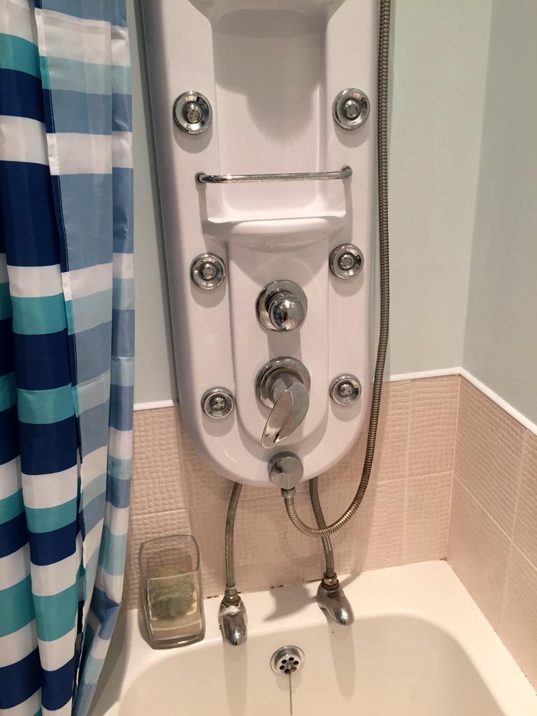

or you could do this 😀
CO4Kc2iWcAAflDY.jpg:large
