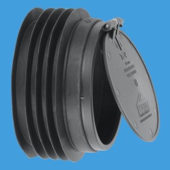

I have a standard flexi (long) 4" waste pipe connected to the back of the pan, which then connects off to the soil stack. I need a solution, ideally a non-return valve at the soil stack end to prevent any ingress at the point of the stack.
The only problem is that McAlpine do a non-return valve, but it's designed to be fitted to the pan, to prevent rodents coming up into the pan. This for me is no good, as I want to prevent whatever it is that is coming in via the soil stack from getting past that point. So that means a non-return valve at the soil stack.
Ideally I would have liked to have used proper plastic polypipe, but the angles involved just wont allow it.
Now - the McAlpine valve does actually look like it would fit onto the end of a standard 4" flexi pipe when the existing gasket/seal is removed, but guess what, they are indeed different sizes!!! The non-return valve is bigger than the end of the flexi-hose!!! The difference is probably only 2-3mm, but as we are talking water, I need to know that whatever I put in place is going to be water tight.
you could get something like this from mcalpine View attachment 20836
I went to my local shop and looked at this, but it is designed to fit the pan itself, not at the other end of the flexi. I offerred it up to the end of a flexi and they are different sizes (approx 2-3mm) so I don't think this will work.
if you get a flexi on which you can remove the finned bit on the end, this will fit in it's place.
