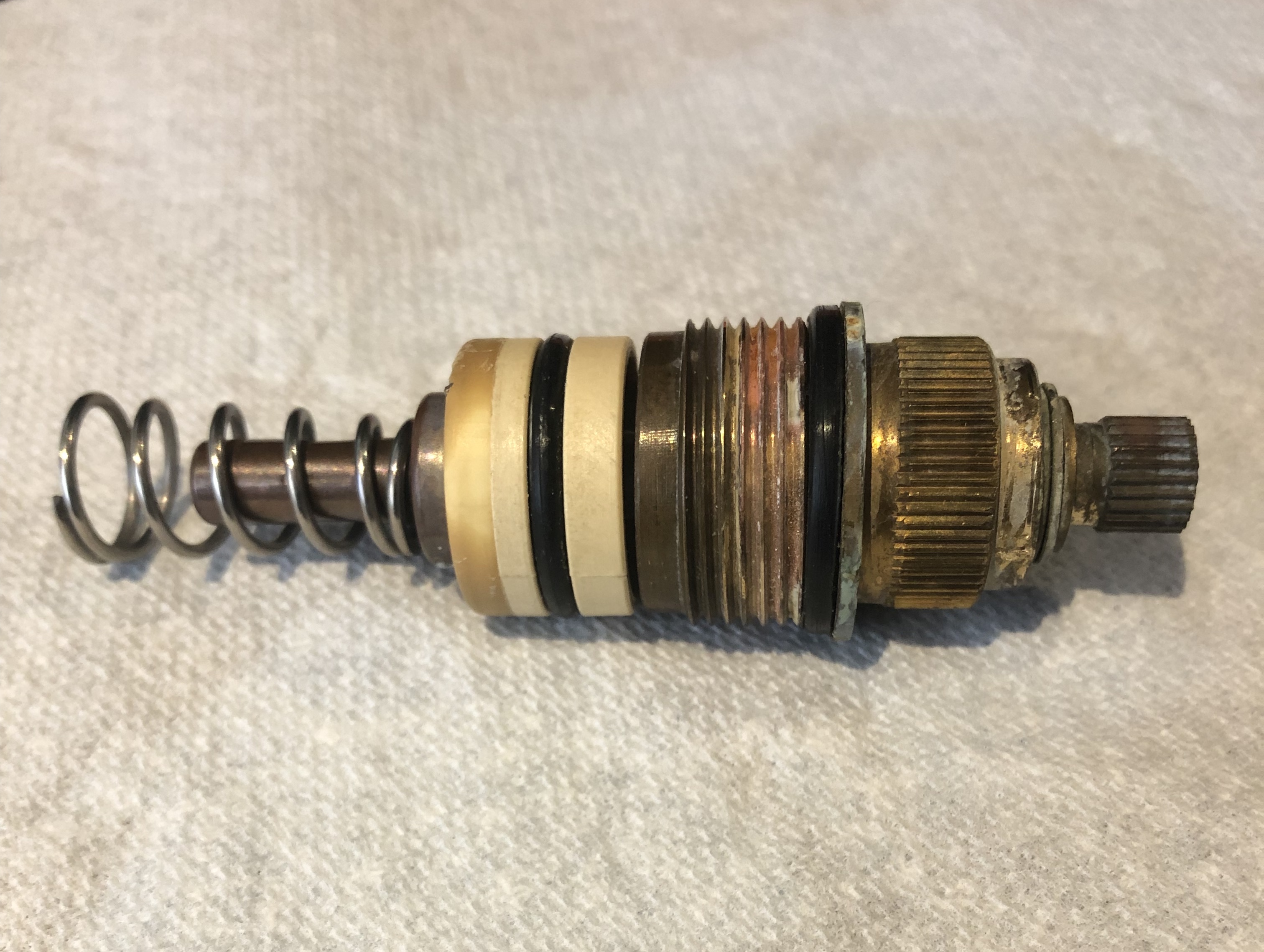

Hi Guys,
I have a leaking thermostatic cartridge and I'm trying to replace it but I cannot find the part number or any no-name ones with similar measuring.
I bought the shower from Victorian Plumbing and it is the Milan Modern Thermostatic Shower in Chrome. It was bought in 2015 and their supplier for this shower at that time was Cassellie but neither VP or Cassellie can tell me about the replacement part. I've sent pictures to their recommended suppliers but none of them could match it !?! ...these are plumbsparesdirect, divapor, tapmagician and a local plumbing shop; went to Screwfix as well but they don't have to many options.
I think the main culprit for the leaking is the worn rubber on the element but not sure; see pics below and let me know if you've seen one of these; I hate to change the whole shower just for this... 🙁

That’s the trouble with Victoria plumb. It’s all Chinese and they only do a one, to two year run on production.
They keep no spares and they make none.
Generally the only way is to buy the complete shower mixer, or replace.
Thank you Chalked. Probably that's why they cannot tell me where to buy it from 🙁.
I've learned the hard way and probably best to find a different shower with same measurements rather than buy the same...I have some really nice porcelain tiles 🙂 but I have a feeling that I might struggle to find similar shower as well due to their "bespoke" manufacturing approach!
I will continue to search on eBay and some other local plumbing shops ....maybe I will find it eventually!
P.S I did tell my wife on that time: let's not cut corners on this bathroom refurb! expensive tiles and random shower doesn't work! ...but I am second in line at decision making in this house 🙂...after the dog!
I know this is an old thread but thought I'd add my experiences for anyone searching for this. We also have the Milan Modern Thermostatic Shower from Victorian Plumbing - been in about 2 years, and we hit exactly the same issue. The shower keeps running lukewarm, and no amount of cleaning the cartridge makes any difference. Tried to obtain a replacement cartridge, hunted high and low and tried various suppliers and you just cannot get them, the only way it seems is to buy a complete replacement unit. I contacted Victorian Plumbing and they were no help. Not a great experience tbh.
We ended up replacing the entire shower with a brand new Bristan mixer which had the same fittings, so we could make sure we could get the cartridges in the future.
I noticed that Victorian Plumbing have since updated their website with what looks like a replacement part number - MS703 - but at the time I contacted them they didn't have this. So maybe it's now possible to get a cartridge for it for anyone willing to try.

Are you absolutely sure? I find this hard to believe - I have recently replaced the cartridge in a 21 year old hansgrohe concealed shower and it then worked perfectly.
Most more recent showers take the same cartridge as one another 94282000; there are of course a few other ones- I’ve never come across one that I can’t get a replacement for…
